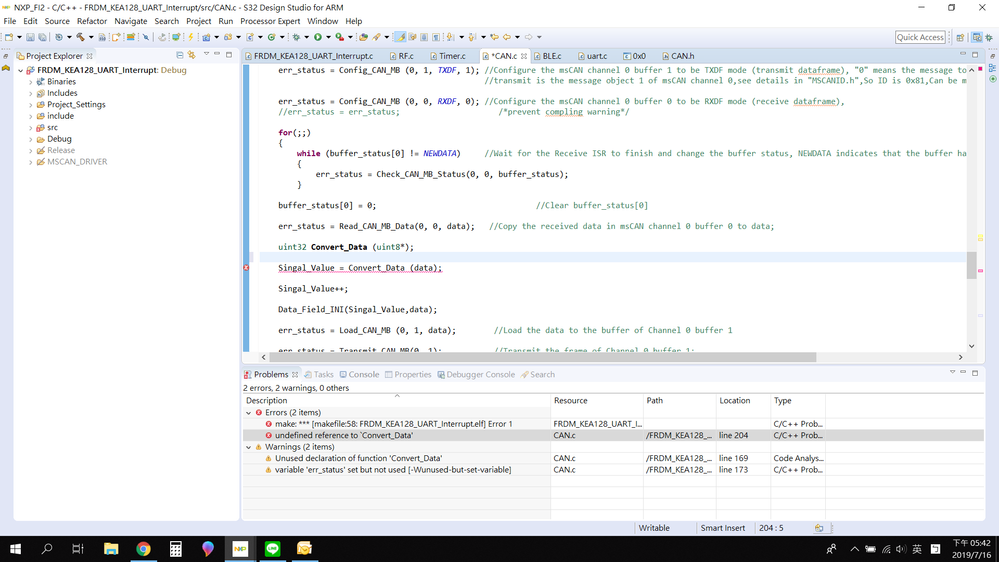

My program like it:
When I build project,it has a error:undefined reference to "Convert_Data".
But,I defined it at previous row.
Even if defined as global variable.
It still has same error.

thanks for sharing project. Convert_Data function is not implemented in your project. It is only declared - that's why linker can't find it.
Jiri

where is Convert_Data() function defined? You can try declare it by this way (if it is in different object file):
extern uint32 Convert_Data(uint8* data);
Jiri

Here.
Although I have not seen this usage.
My program is modified using the official sample program.
https://www.nxp.com/webapp/sps/download/preDownload.jsp
Bold guess,there are some problems with the compiler.
My program file:
https://drive.google.com/open?id=1MUmB-Bl79LJpjjJRard3N5O07nWw280S
Jiri
