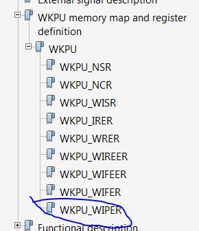

Recently, in learning WKPU of MPC5746C, I found that the library file has a register, but there is no such in the manual. The following figure,This register is WIPDER. What is the meaning of this? Is that wrong?

I'm not sure from which header file is your screenshot, but in MPC5746C.h is this register named correctly - WKPU_WIPER. More details you can find in Reference Manual - https://www.nxp.com/docs/en/reference-manual/MPC5746CRM.pdf
page 593.

It is mpc5746c.h in s32ds.
Yes, the manual is WKPU_WIPER, and the definition of the S32DS library file is wkpu_wipder.
