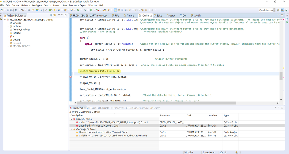

My program like it:
When I build project,it has a error:undefined reference to "Convert_Data".
But,I defined it at previous row.
Even if defined as global variable.

thanks for sharing project. Convert_Data function is not implemented in your project. It is only declared - that's why linker can't find it.

where is Convert_Data() function defined? You can try declare it by this way (if it is in different object file):
extern uint32 Convert_Data(uint8* data);

pg31321
Here.
Although I have not seen this usage.
My program is modified using the official sample program.
