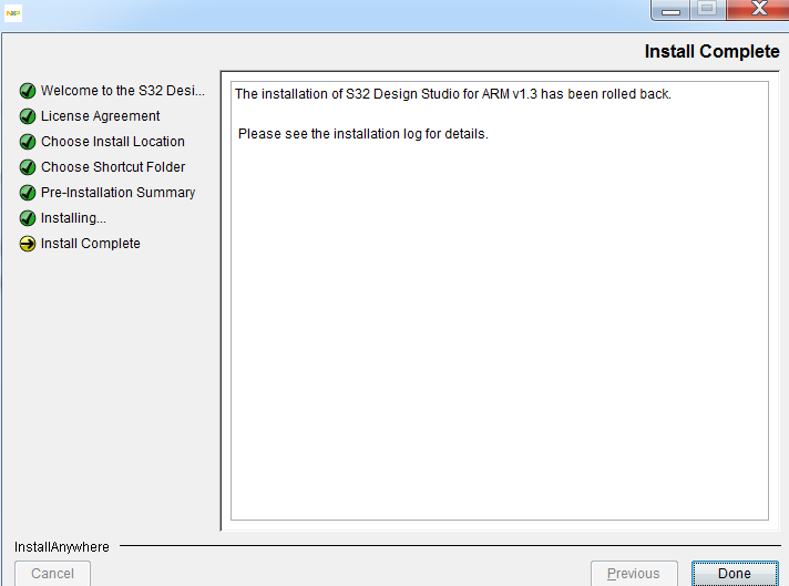

Is there a problem with the Offline activation of S32DS? I have created the request.xml using the activation code provided by Software & Support : Licensing. When using the activation.xml file returned by Software & Support I get an Invalid Offline Response. The installer then roll back the installation.
Original Attachment has been moved to: S32_Design_Studio_for_ARM_v1.2_Install_07_21_2016_07_39_18_2.log.zip

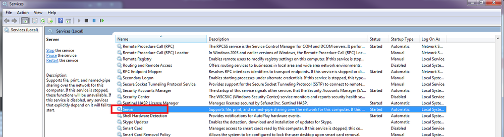

stanish
There could be several reasons why you cannot install S32DS:
  • make sure you have admin rights and your Windows server service is enabled. see e.g.
Fail to install S32DS for Power Architecture v1.2
  • make sure you entered correct Activation ID. Each product version is using its own Activation ID. E.g.  you cannot mix Activation ID for S32DS Arm to activate S32DS for Power. Activation ID must match also with the product version (S32DS ARM 1.3 Activation ID will not work with S32DS ARM 2.0)
  • in case of the offline activation problems see this:
S32 Design Studio Offline activation issue hot fix
Stan

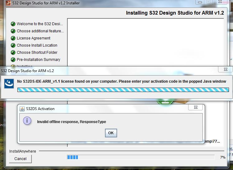

yulianmatev
Hello all,
I am also not able to make an offline activation. I tried also with suggested activation code 37D6-B186-B306-B6AA but it is also not working: "Invalid offline response, ResponseType"
I tried also logged in as the built in user Administrator -> the same result.

stanish
Hello Han,
Apologize about inconveniences.
Have you had another instance of S32DS v1.1 installed and activated already?
Could you possibly try to activate  it once again (online/offline).
If it does not work with your original activation ID could you give a try with the "workaround" one we published:
37D6-B186-B306-B6AA
Thanks!
Stan

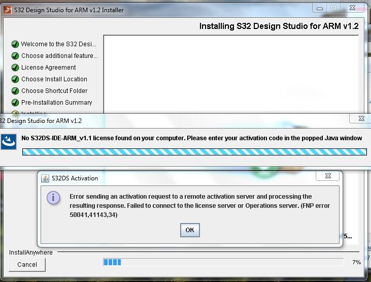

tigerdawn
Hi Stan,
Thanks for your kindly reply.
Last weekend I have tried on my PC at home and there's no installation issue with my original activation ID.
But I also tried 37D6-B186-B306-B6AA last week and there is another issue shown below if I choose activate online, offline method was still the same. All of this happened on the laptop on my workplace .  I will try again today. Thanks!

stanish
Hi Paul,
First of all we apologize about the inconveniences. We are currently experiencing some activation issues on a small fragment of activation codes.
According to our records, you finally activated the tool. Am I right?
If not can you possibly try to activate (online/offline) using the testing activation code below:
37D6-B186-B306-B6AA
Please let us know if it works
Thanks!
Stan
