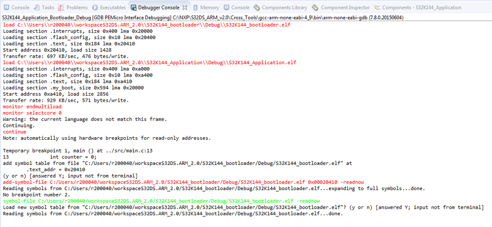

I poked around at a few guides, namely this one (“No source available”, or how to Debug Multiple Binaries with GDB and Eclipse | MCU on Eclipse ) and in Debug Configurations-> Startup -> GDB run commands I added the following (where 0x10410 is the .text space according to the map file)
add-symbol-file "[file path]Bootloader_A00.elf" 0x10410
In my debugger console I see the following;
add symbol table from file "[file path]Bootloader_A00.elf" at
.text_addr = 0x10410
(y or n) [answered Y; input not from terminal]
Reading symbols from [file path]Bootloader_A00.elf...done.

I'd suggest you to rather switch the symbol files via "Debugger Console" / GDB client console as a workaround.
e.g. to load bootloader symbols type the command below into GDB client console:
symbol-file <Path_to_your_BL_elf>\S32K144_bootloader.elf -readnow

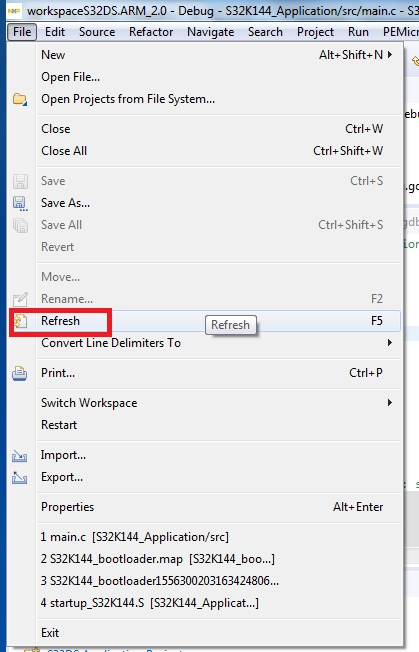

* refresh the IDE (menu File ->

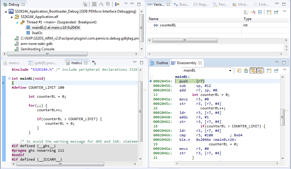

and now the bootloader sources/symbols are available:

gearhead1107
Thanks, Stan - this definitely works as a temporary solution.
One important note for anyone following along is that you have to refresh the debug context - not the file explorer context.
