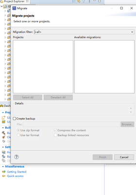

hi,
i want Migrate prj from S32DS for ARM version2018.R1 TO S32 platform 3.4
i do this:
  1. Click File > Import... > General > Existing Projects into Workspace, then click Next.
  2. Click Browse... and browse to the project location, click OK, select the Copy projects into workspace option, then click Finish.
  3. i  click migrate it show the picture,have no prj;
it confuse me,how migrate prj.
thanks!

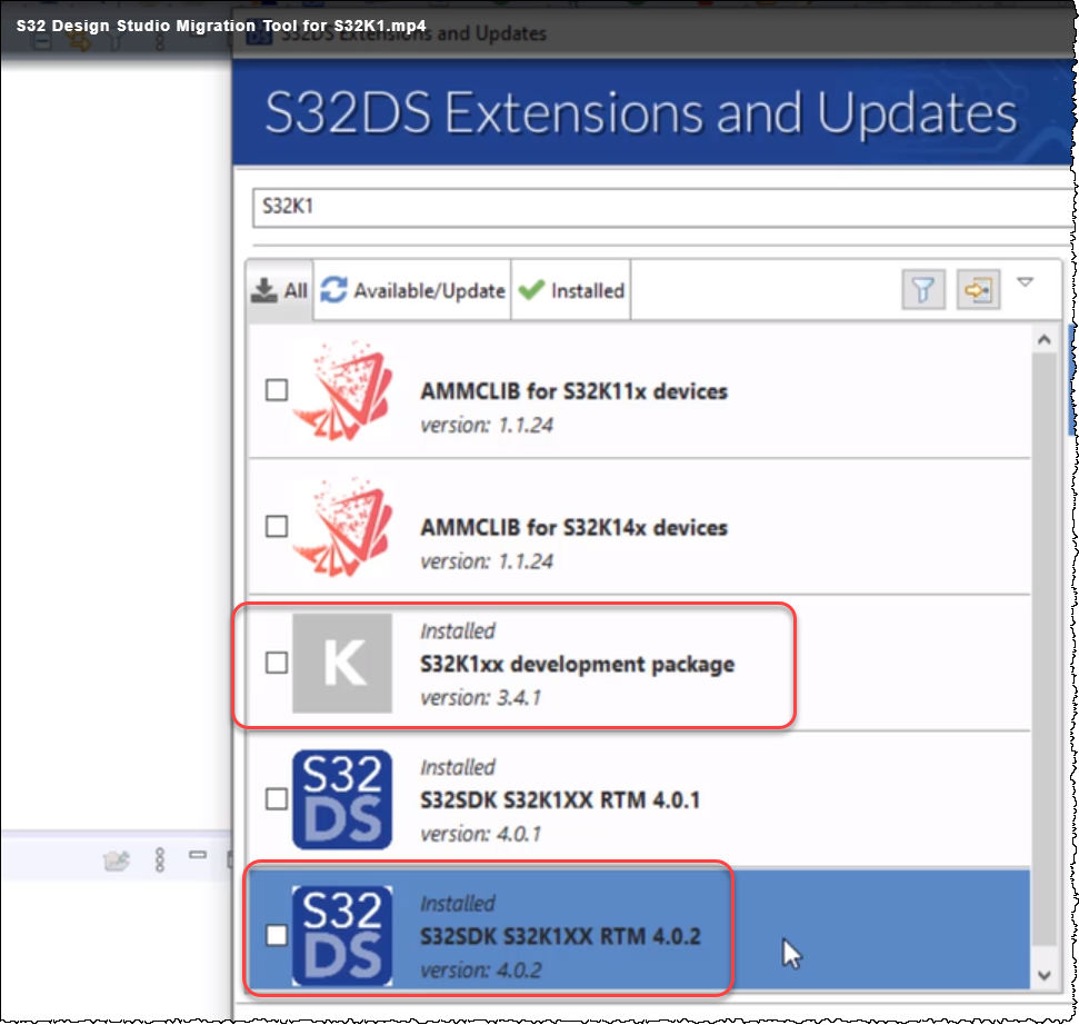

Please refer to Video: Migrating S32K1 projects from S32DS for ARM and SDK 3.0.x to S32DS 3.4 and SDK 4.0.2
S32K1xx development package and S32SDK S32K1XX RTM 4.0.2 need to be installed.
S32K1xx development package S32SDK S32K1XX RTM 4.0.2.pngS32K1xx development package S32SDK S32K1XX RTM 4.0.2.png
Robin

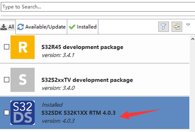

hi,
i haven installed the S32K1XX development package ,but the IDE only have S32SDK S32K1XX RTM 4.0.3,not

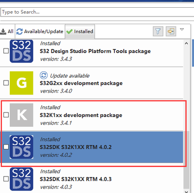

Please install S32 SDK for S32K1xx RTM 4.0.2 offline.(S32 Design Studio v3.4 S32K1 Service Pack 1 released!)
3,702件の閲覧回数
oceansea
hi,

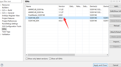

now i installed S32K1XX deveiopment package and S32SDK S32K1XX RTM 4.0.2
but when i click migrate ,it still have nothing;
thanks
