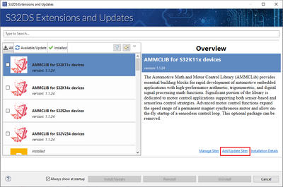

  •  online installation:
    • go to menu "Help" -> "S32DS Extensions and Updates" dialog
    • select from available items and click "Install/Update" button

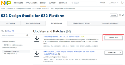

    • go to S32 Design Studio product download page: S32 Design Studio for S32 Platform -> Downloads, click 'Download' button next to S32 Design Studio S32K1xx Service Pack 1

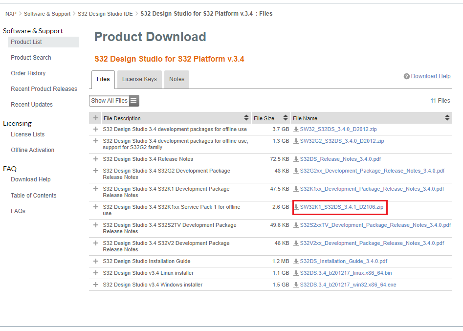

    • from the Product Information page, select S32 Design Studio for S32 Platform v3.4
    • then select 'SW32K1_S32DS_3.4.1_D2106.zip' to download the update archive zip file

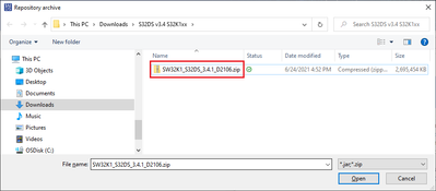

    • Start S32 Design Studio and go to "Help" -> "S32DS Extensions and Updates"
    • Add the downloaded archive as a software site. Click "Add Software Site" and browse to select the archive file downloaded in the prior step
    • Select from available items and click "Install/Update" button.
