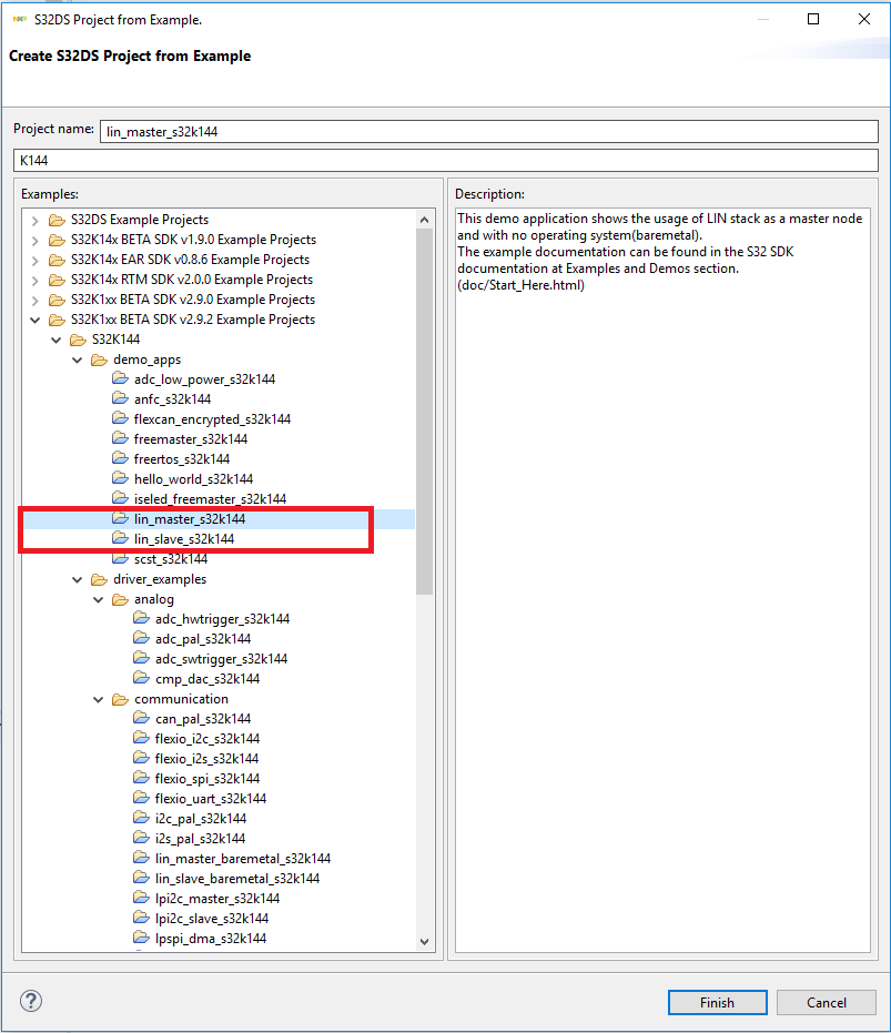

I want to configure LIN communication over S32K144EVB-Q100
Where can i get LIN Example Code?
4,176 Views
stanish
I'd recommend you to install the latest S32DS for ARM:
S32 Design Studio for ARM 2018.R1 (Windows/Linux) released!
 and the latest update:
S32 Design Studio for ARM 2018.R1 - Update 8 available
And create a new S32DS project from example (use the latest SDK examples v2.9.2):
Hope it helps.
