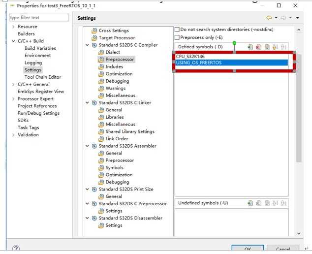

I develop software with S32KDS for ARM 2018R1. I find FreeRTOS v8.2.1 has been integrated with S32DS, but I want to use FreeRTOS v10.1.1. I did as following documents:
--《Tutorial: FreeRTOS 10.0.1 with NXP S32 Design Studio 2018.R1》
---《Using custom FreeRTOS with S32K SDK and OSIF for ARM》
by the way, I defined the symbol as following:

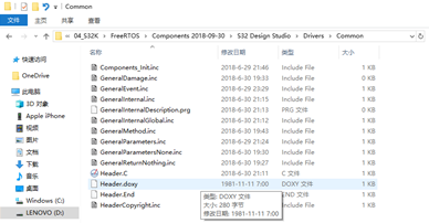

I download the McuOnEclipse FreeRTOS component, but I found there is no file: Header.h, shown as following:

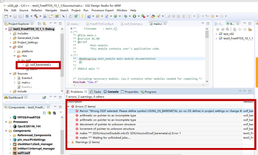

1. But , after the component osif being added into my project, and building my project the following error is shown.I found the file osif_baremetal.c  instead of  osif_freertos.c.
How can file osif_freertos.c be got?

FreeRTOS v8.2.1 is the version supported by S32DS and SDK. If you like to use different version - it is up to you how to implement it. It looks that ErichS‌ solution si working for others - Tutorial: FreeRTOS 10.0.1 with NXP S32 Design Studio 2018.R1 | MCU on Eclipse
osif_freertos.c file is located for example in
[YOUR_S32DS_INSTALL_PATH]\S32DS_ARM_v2018.R1\S32DS\S32SDK_S32K14x_RTM_2.0.0\rtos\osif\
or in similar path in any other SDK version folder.

I did as Eric Styger suggested. My problem is that: when I click "generate code" button,  in folder "SDK", osif_baremetal.c  is shown, it is wrong.
I think osif_freertos.c should be generated automatically into folder "SDK".
How can osif_freertos.c be shown in folder "SDK" automatically?
