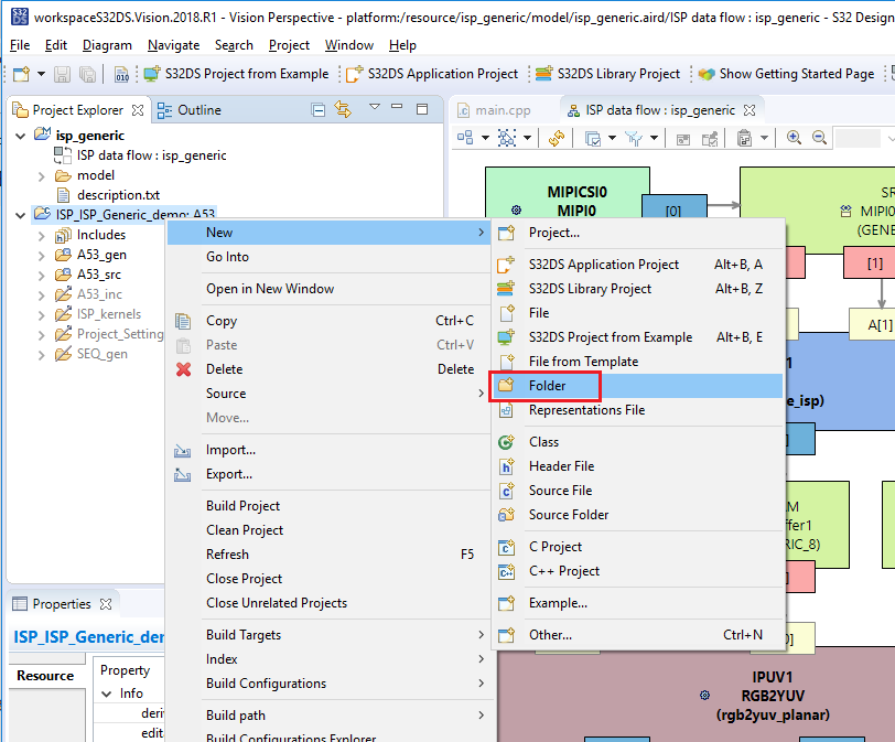

13) Define a new configuration for emitting code from the graph
      a) Create a folder in the application project to receive the emitted code. Right-click on the application project and select New -> Folder.
      b) Enter a name for the folder and click Finish
