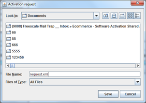

Step 2. The Offline process will require to save an activation request file -"request.xml". Please save this file into a local folder or an USB drive.pastedImage_1.png

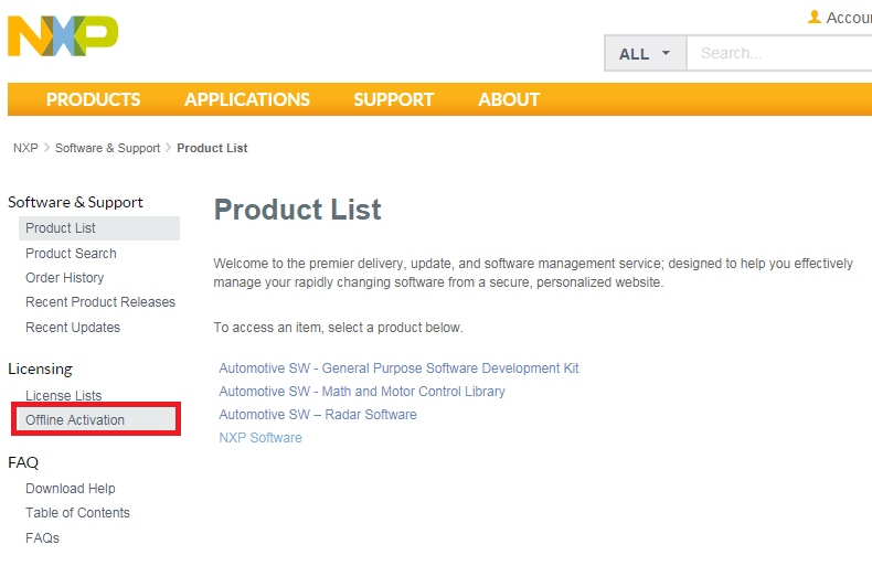

Step 4. Look for the Internet connection and take the "request.xml" file with you. Go to https://www.nxp.com/security/login  click on Apps and Services >  "Software Licensing and Support > Click on View Accounts

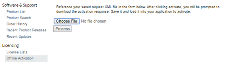

Step 5. In product information page look for the "Offline Activation" option on the left menu.

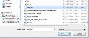

Step 6. Click on "Choose File" and select the "request.xml" file generated in Step 2.  Press "Process" button to get the "activation.xml" file. This file will be downloaded.

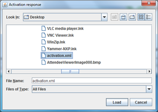

Step 7. Save "activation.xml" file and take it to the original offline station, go back to the Activation response dialog described by Step 3.
Step 8.  Load file and installation will be finished. S32 design studio will be activated with your activation ID.

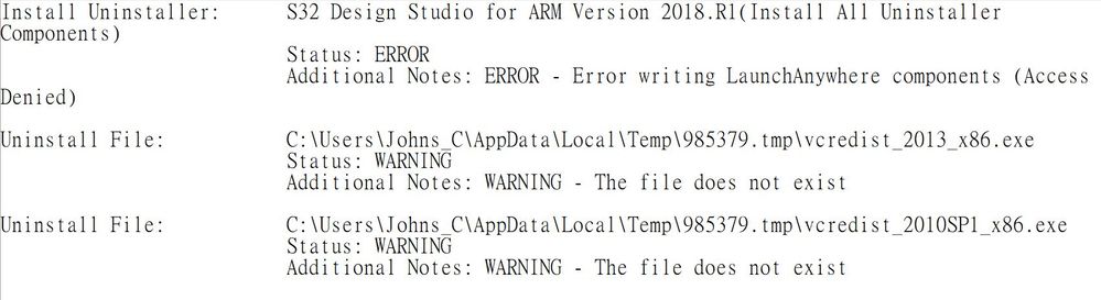

I didn't even have the "offline" option in the first step, the installer will automatically quit...
I think it may be a problem with the activation key, but I don't know where to fix it...
However, the log file shows...

Its seem that web pages had changed. Where is the page which is used for submiting the request.xml?/sad
Find it. Software & Support : Offline Activation
It takes me 3h to solve this problem. Remeber to generate the activation.xml through the request.xml that is generated by the setts.(Reference another official method)
