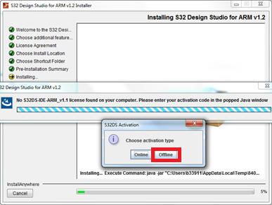

Step 1. S32 Design studio for Arm/Power/Vision installer pops up the "S32DS Activation" dialog  where you first enter your activation ID and select activation type as offline
Step 2. The Offline process will require to save an activation request file -"request.xml". Please save this file into a local folder or an USB drive.pastedImage_1.png

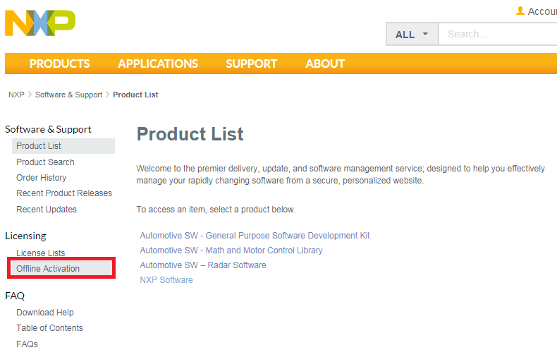

Step 5. In product information page look for the "Offline Activation" option on the left menu.

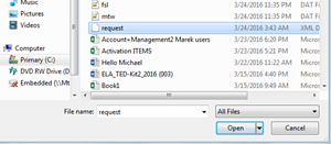

Step 6. Click on "Choose File" and select the "request.xml" file generated in Step 2.  Press "Process" button to get the "activation.xml" file. This file will be downloaded.
Step 7. Save "activation.xml" file and take it to the original offline station, go back to the Activation response dialog described by Step 3.
Step 8.  Load file and installation will be finished. S32 design studio will be activated with your activation ID.

Its seem that web pages had changed. Where is the page which is used for submiting the request.xml?/sad
Find it. Software & Support : Offline Activation
