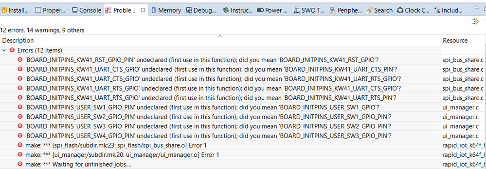

Compiler error: 'BOARD_INITPINS_KW41_RST_GPIO_PIN' undeclared (first use in this function); did you mean 'BOARD_INITPINS_KW41_RST_GPIO'?
6,338 Views
alejandro_abrah
I have installed the newest SDKs in MCUXpresso but I cannot get rid of the error:
What could I do to solve this ?
Thank you.
Best,
Alejandro

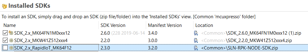

alejandro_abrah
Hi Estephania,
There are the steps I follow:
1. Import SDK from NXP website: SLN-RPK-NODE-SDK.zip
2. Import SDK Example from MCUXPresso
3. Set the options for the Hello World example.

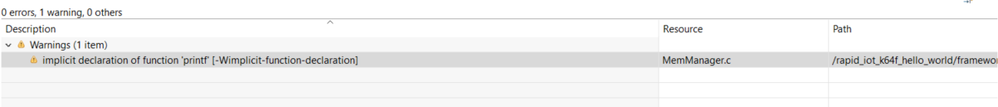

4. Replace THCI_Debug with printf
5. Buil and I get no error at all:

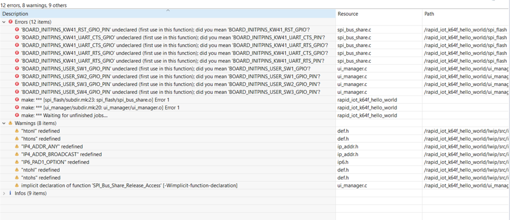

6. I go to ConfigTools from within MCUXpresso and select: "rapid_iot_k64f_hello_world".
7. Once it finally loads, I hit "update project"
8. THen go back to "Develop".
9. Build and I now have lots of errors again:
I cannot attach the Hello World exported project from my IDE at this section.
