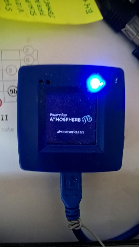

My device is broken it starts until the Atmosphere screen then it stops with the blue LED continu on, no further activity.
-None of the resets helps
-New 'out of the box firmware.bin' does not help.
-Other .bin files from the NXP website will upload to the device but end in the same screen.
M 0060370000127D20
ID 410486749406069B

I do not believe your kit is dead... I rather suspect a SW issue.
I need to ask few questions to figure out what happened and how to fix.
- Do you have a hexiwear docking station?
- Can you confirm you can still enter MSD mode to reflash FW ? (seems to be the case from what you wrote)
- Did you try switching to THREAD mode ?
Flashing the latest out of the box application FW, and connecting your kit to your PC, you should be able to see a log in a terminal window (teraterm). PLease provide me with this log so I can figure out what is wrong - I have attached my Teraterm set-up to save you time

From what I can read it looks your KW41Z µC is corrupted, K64 looks fine.
Here is the reasonning if you are interested - can help understanding the how the kit works better:
- K64 boot loader seems also ok, cause you can still use MSD mode (Most of the time users crash the k64 bootloader leading to a kit not booting at all)
- The K64 cannot complete its booting sequence therefore you are stuck. This said it looks ok from the log
- We can read in the log that K64 is asking KW41Z Mac address and not getting any answer.
  • Am not sure yet whether just reflashing the core image will be sufficient, but we can try:
You mentionned you tried flashing different apps, but can you confirm you tried flashing the KW41Z hybrid application ?
The process to flash the KW41Z hybrid application is the same as for a K64 image (Reset + SW3 and drag and drop)
Am attaching the latest version to this message. This is the one to use.
Because you have not used the hexiwear docking station, I would be very surprised that the KW41Z bootloader is coorupted.

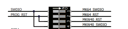

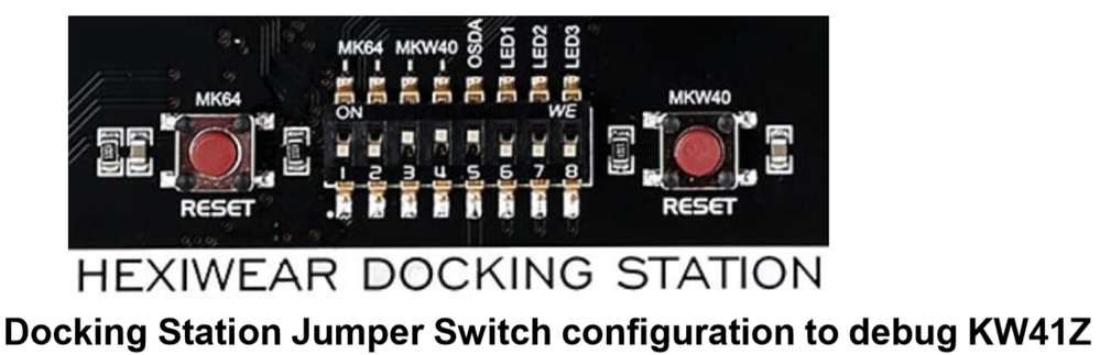

I tought that i needed a Hexiwear dockingstation in order to programm the bootloaders  as i read in the manual here; 4.1.5. (Re)Programming of K64F and KW41Z Bootloaders.
In the attached picture i understood that you have to select the chip with the dip switches before programming, that did I understand, just dropping it in by usb i don't understand.

Without docking station, K64 parses the binary and detects whether it is a K64 binary or a KW41 binary and passes on to KW41Z when applicable. As the only 'input' is USB directly to K64, K64 needs to mange this
On a docking station it goes though K20 first via USB and then, we can redistribute the signals directly to the right micro controler via the switches:
This also explains why it is very easy to overwrite bootloaders with a docking station while it is not easy when kit is directly plug to PC via USB
