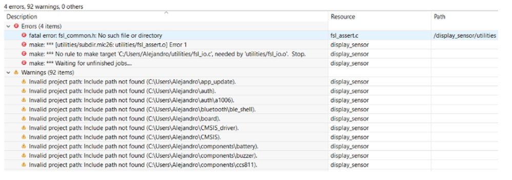

I have downloaded the examples. But when compiling I get the error that many of the libraries are missing. The libraries seem to be in the kit original SDK, but somehow they are not imported by MCUXpresso when creating the project.
What can be done to solve this ?
By the way I have downloaded the latest compiler:
Product: MCUXpresso IDE
Version: MCUXpresso IDE v10.3.1 [Build 2233] [2019-02-20]
Operating system: Windows 10
VM: Java HotSpot(TM) Client VM (32 bit)
Thank you.

I believe those are not the latest version, still , do you have the issue just with the SDK or is it with a project you imported?

I was able to reproduce the issue on the latest version with some examples, I'm investigating about this... as soon as I get any update , I'll let you know

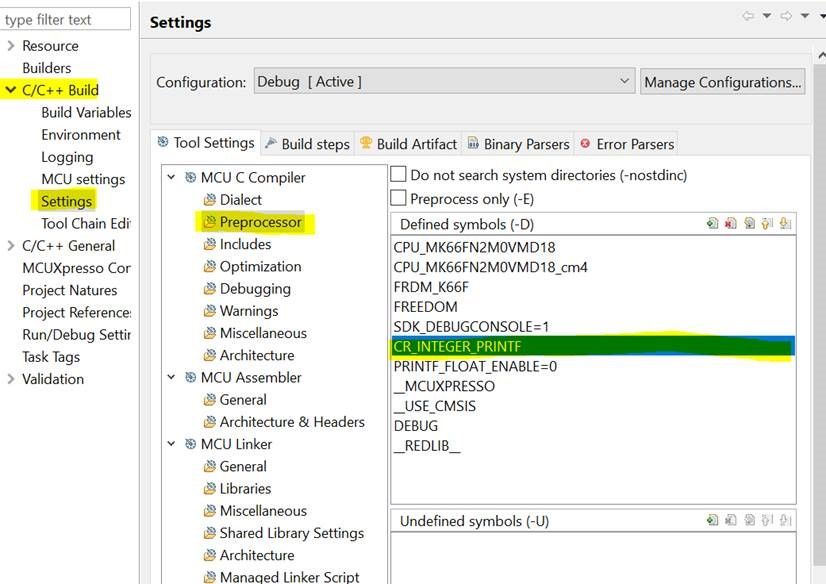

Could you please try the following ?
Please go the project settings following the path C/C++ Build -> Settings ->MCU C Compiler -> Preprocessor and remove the symbol “CR_INTEGER_PRINTF”.
Please let me know if that works for you.
