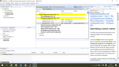

I got this error and the only info that I have is
Description Resource Path Location Type
Property DDR_RATE is set to a custom value. LS2088ARDB-Ben1 PBL1 Problem
It is not very usefull.
I pass every section in Properties page but I did not find any custom value.
Screenshot from 2021-01-14 23-27-14.pngScreenshot from 2021-01-14 23-27-14.png
I attached the PBL binary file. Note I add .c to be able to upload it but it's a binary file.

1.From Component Inspector view, select Enable/disable error checking menu, and then choose Skip error checking option, as shown in the figure below.
