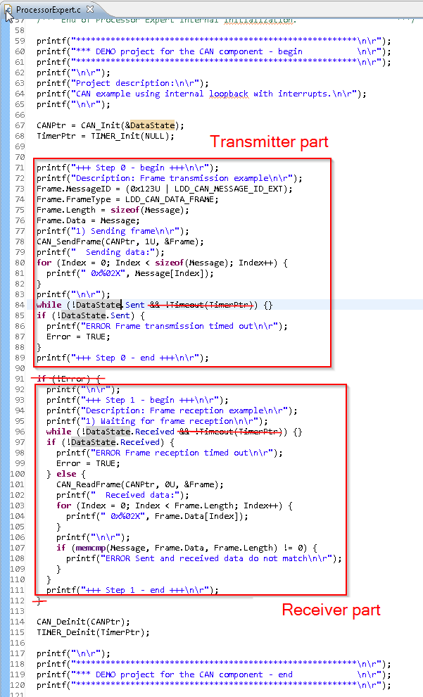

serhatitu
How about the codes Petr?
Should i upload same codes to two boards, i think it must be different.
In loopback example it is sending  and also receiving data itself. Therefore i think uploading same code to two boards will cause problem.
6,654 Views
Petr_H
Yes, you are right, I have described only component setup. You need to duplicate the projects and slightly modified code for both boards.
For the first try, it should work to just remove the stroke-through lines and keep only receiver part in receiver project and transmitter part for transmitter according to this picture:
best regards
Petr Hradsky
Processor Expert Support Team

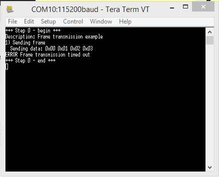

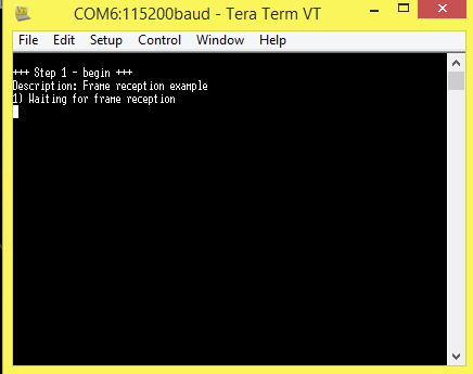

I would like to create CAN communication between two kinetis k60D100M board. I already create 2 different project, CAN Transmit and CAN Receive. But when I'm trying to run the project, it seems to be not working. Is there any hardware configuration (jumper) should I made? Thanks for you help.
send.PNG.png !

zhongshen
Hi agungdeffendi
I have met the same problem. If you fix it please share your solution.
Thanks.
