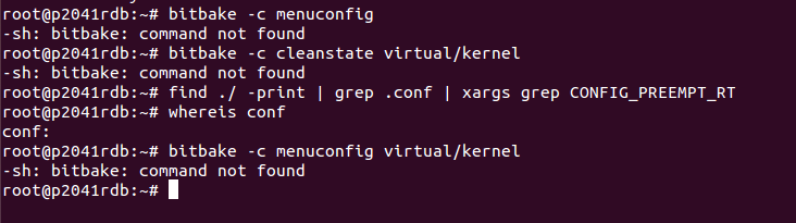

I am trying to edit the configuration files using bitbake but the terminal does not recognize my bitbake commands. I am trying to go off the instructions on this link https://freescale.sdlproducts.com/LiveContent/content/en-US/QorIQ_SDK/GUID-8C4D9C9C-BC81-488D-B2E8-B.... I am running Linux on a P2041rdb SDK V1.4.

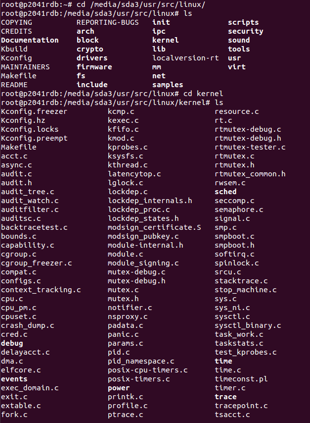

No. This directory is on your target and contains no configuration files. The online guide you are trying to follow implies
that you properly installed the SDK and unpacked the source on an x86 host. Please familiarize yourself with the SDK
getting started guide:

dshannon55
Hi again Platon,
So does this directory contain the proper config file to make the changes from the step-by-step guide I was trying to follow in the beginning? Here is the link to the guide I am talking about... It is suppose to be how to enable the real-time patch.
https://freescale.sdlproducts.com/LiveContent/content/en-US/QorIQ_SDK/GUID-5E34A886-778F-470E-8C9B-5...

It's not possible to give any suggestion  without seeing how the system reacts to your inputs. Can you please share
a session log?
Platon
1,491 Views
dshannon55
Like this?
1,491 Views
bpe
bitbake is a central tool of QorIQ SDK which is a cross-platform SDK. You should install and run it on an x86 host. There are no provisions to run bitbake on a target board. Study my comments in the thread at the link below for more explanations and pointers to available documentation:
