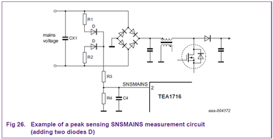

We have a question about the connection of pin 2 (SNSMAINS) of the TEA1716T.
Is it possible to apply a bridge-rectified voltage to pin 2 (SNSMAINS)?
(Connection like the attached circuit diagram.)
This connection is the same as FIG. 26 in AN11179.
In FIG. 26 of AN11179, a diode-rectified voltage is applied to pin 2 (SNSMAINS).

Yes, it is possible to apply a bridge-rectified voltage to the SNSMAINS pin, as shown in your schematic. This approach is valid and supported by the TEA1716T.
BRs, Tomas

Thanks for reply.
That's useful information for us.
Question solved.
