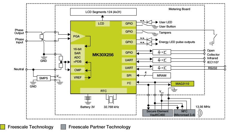

Security is an increasingly key concern in the Smart Metering market. Coupled with the need for greater control over energy expenditure and ease of recharging credits for energy usage, NXP® has the perfect market requirement for secure prepayment via an electricity meter with near field communications (NFC) technology.
  • This reference design provides a secure prepaid electricity meter with the ability to securely reload an energy balance
  • Firmware for this reference design is based on MQX™ RTOS
  • A variety of communication interfaces are available for remote data collecting, making this an ideal solution for residential metering
Features
  • Rich in Security features (Authentication, Secure storage)
  • Physically secure due to Hermetic Sealing
  • Energy balance reload through near field communications
  • Remote secure interfacing (through smartphone)
  • Ability to reload the meter’s balance
  • Anti-counterfeiting check
  • Integrated Metrology Solution based on Arm® Cortex®-M4 Core
  • MQX™ RTOS based design is suitable for advanced markets
  • Cost-effect BoM
Block Diagram
