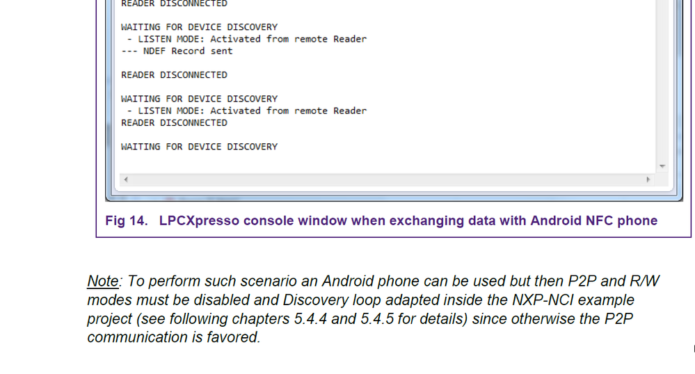

I have two OM5577 modules. One is connected to a beaglebone black which is running the NXP image with the sample NFC application. The other is connected to the LPX82x Xpresso development board, onto which I loaded the NXP-NCI sample application.
When running tag emulation function on the beaglebone, my Android phone picks up the tag successfully at about 1.5" away. However when running the tag emulation test on Xpresso board, I have to practically touch my phone to the antenna. Additionally, in the Xpresso board case, my Android app shows a toast message "Tag detect communication interrupted", even through the debug Console in Eclipse shows that the tag sent data to the phone successfully:
- LISTEN MODE: Activated from remote Reader
--- NDEF Record sent
Questions.
1. Why such a big discrepancy between in tag sensitivity between the two cases. The module is identical. Could it be my power supply (beaglebone uses 2A supply wheres the Xpresso board is hooked up by USB to my PC).
2. Why might my phone not ready the tag fully?

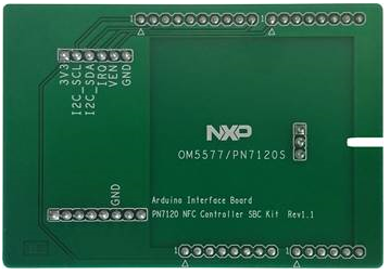

Also, do you have an Eagle version of the hardware design files?
11,032件の閲覧回数
Kan_Li
Hi Oleg,
Yes, our web site provides the download link, please refer to the following for details.
Hope that helps,
Kan

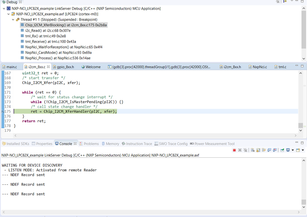

OK thanks, it seems somewhat inconsistent, but I can try to move forward with the evaluation.
Next problem....
After a couple of instances of reading the emulated tag with my phone, the application gets stuck inside an inner loop and no longer works to emulate tags, R/W cards. Below is the screenshot of the top of the stack where it gets stuck. The Chip_I2CM_XferHandler() function always returns 0. This usually happens after an incomplete communication sequence with my phone. Note that we plan to use this demo example as our golden reference for this project. It has to work flawlessly.
Thanks for your help!

Kan_Li
Hi Oleg,
Are you using the project I sent to you via the salesforce? Please kindly clarify.
Thanks for your patience!
Kan
11,028件の閲覧回数
olegstepanov
yes

Kan_Li
Hi Oleg,
I am sorry, after I checked with our expert team, I found the project I sent out is an old version, so there might be issue in it, recommend the SW4325,https://www.nxp.com/webapp/Download?colCode=SW4325&appType=license&location=null&fsrch=1&sr=...  , I just make it work on my side, with LPC82X Xpresso V2.mbed REV B and OM5577 for Arduino, please refer to the NCI logs as below:
Running the NXP-NCI project.

The project settings on my side:
I also applied a hardware solution to improve the RF performance of the OM5577 for Arduino, like below:
This is because of the loop around the antenna created by the ground plane, which can generates eddy current impacting the RF performance. The recommendation is then to cut the loop by cutting the ground plane, just like above.
Please try on your side as well to see if it makes any difference.
Please also enable NCI_DEBUG like I did in the project setting for analyze when the issue happens.

Kan_Li
Hi Oleg,
1. Are you able to scan the tag with your phone being one inch away?
- Yes.
2. Are you running the application directly from MCUXpresso?
- Yes.
3. Are you using the debug probe IC on the board for debugging or an external debugger?
- I used the debug probe IC on the board.
4. Are you running the NXP-NCI_LPC820x sample exactly as provided by NXP, or did you make any modifications?
- I used the original sample without any modification.
BTW, the following is the IDE info:

I attached the Beaglebone cape to the Xpresso board, instead of the Arduino shield. Two things:
1. The tag detection sensitivity drastically improved. I can scan at about 1.5" away now. So, it seems that the Ardunio based shield as some serious RF limitations.
2. However, I my Nxp TagInfo app on my Galaxy S7 is still not able to capture the data without any errors. Here's the video:
Dropbox - TagEmulationFailure.MOV
In the MCUXpresso console I get this:
WAITING FOR DEVICE DISCOVERY
READER DISCONNECTED
I see that in your screenshot, you have two lines with "NDEF Record sent", instead of one.
This is my only reference for this project, so it needs to be working 100%. Are you able to escalate to another support tier? Our hope is to add the PN7120 and supporting parts to our commercial laundry machine modules

Kan_Li
Hi Oleg,
Please also check if you disable P2P and RW mode, please refer to the following for details.
Hope that helps,
Kan

olegstepanov
Are you using LPC824 board? I see you have different symbols defined, including LPCU11. I think you might be running different code from me. I am running the LPC820X_example:
Please try using an LPC82x board with the LPC82X project.
