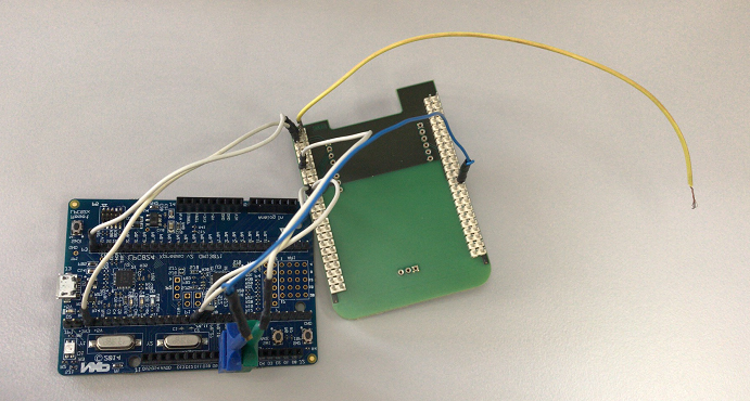

I have two OM5577 modules. One is connected to a beaglebone black which is running the NXP image with the sample NFC application. The other is connected to the LPX82x Xpresso development board, onto which I loaded the NXP-NCI sample application.
When running tag emulation function on the beaglebone, my Android phone picks up the tag successfully at about 1.5" away. However when running the tag emulation test on Xpresso board, I have to practically touch my phone to the antenna. Additionally, in the Xpresso board case, my Android app shows a toast message "Tag detect communication interrupted", even through the debug Console in Eclipse shows that the tag sent data to the phone successfully:
- LISTEN MODE: Activated from remote Reader
--- NDEF Record sent
Questions.
1. Why such a big discrepancy between in tag sensitivity between the two cases. The module is identical. Could it be my power supply (beaglebone uses 2A supply wheres the Xpresso board is hooked up by USB to my PC).
2. Why might my phone not ready the tag fully?

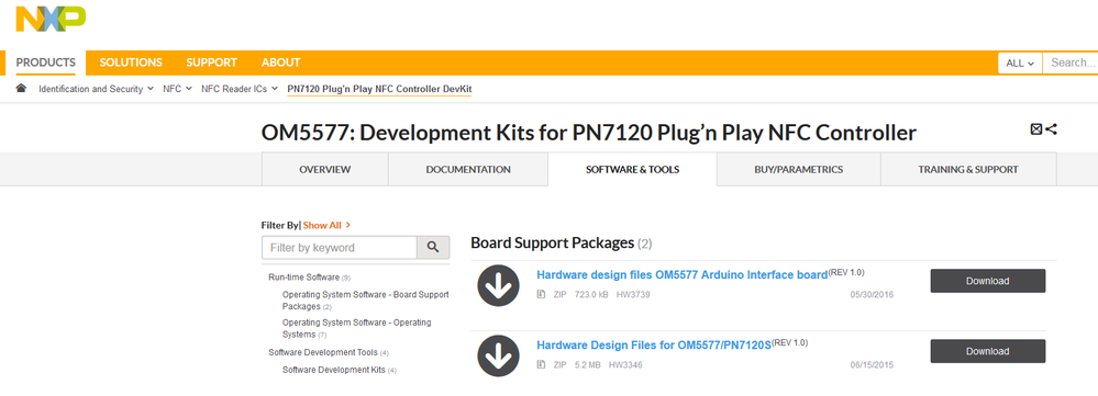

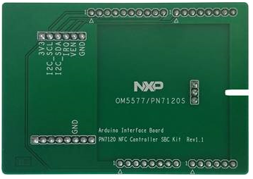

Also, do you have an Eagle version of the hardware design files?
11,242 Views
Kan_Li
Hi Oleg,
Yes, our web site provides the download link, please refer to the following for details.
Hope that helps,
Kan

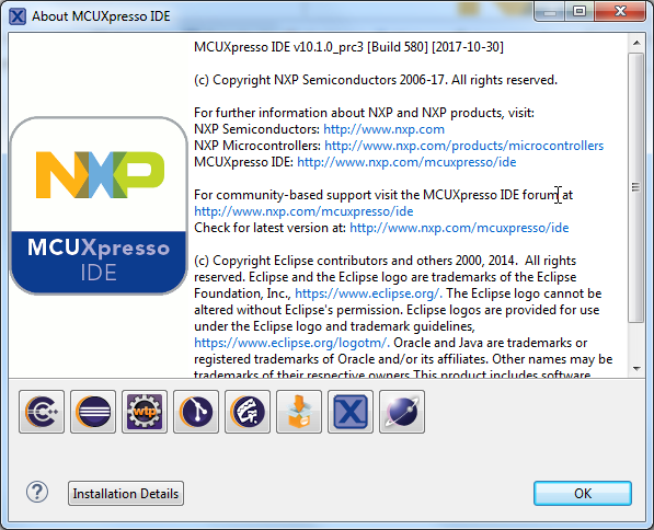

BTW, the following is the IDE info:
Kan

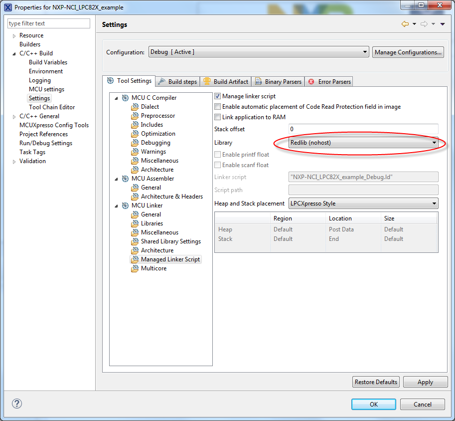

- Maybe the connection issue, you know, the LPX82x Xpresso development board has the arduino interface instead, please check the connection on your side.
2. how can I run the application on the Xpresso board without launching it through eclipse and debug probe (i.e by just applying power to the USB). I tried setting JP1, but it doesn't seem to be running.
- Try to disable the semihost feature of the lib.
Hope that helps,

I attached the Beaglebone cape to the Xpresso board, instead of the Arduino shield. Two things:
1. The tag detection sensitivity drastically improved. I can scan at about 1.5" away now. So, it seems that the Ardunio based shield as some serious RF limitations.
2. However, I my Nxp TagInfo app on my Galaxy S7 is still not able to capture the data without any errors. Here's the video:
Dropbox - TagEmulationFailure.MOV

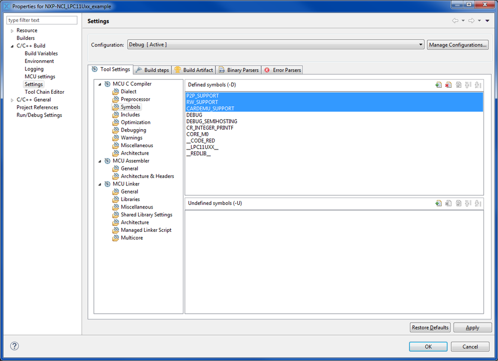

Please also check if you disable P2P and RW mode, please refer to the following for details.
Hope that helps,
Kan
11,242 Views
olegstepanov
Are you using LPC824 board? I see you have different symbols defined, including LPCU11. I think you might be running different code from me. I am running the LPC820X_example:
Please try using an LPC82x board with the LPC82X project.
