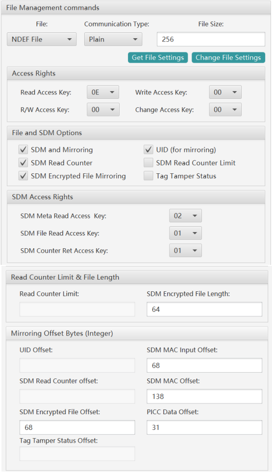

I successfully modified the file settings according to the AN12196.pdf document, but an error occurred when I wanted to customize the CmdData.
The following is my CmdData:
40 00 E0 D1 F1 21 1F 00 00 44 00 00 44 00 00 40 00 00 8A 00 00 80 80 80 80 80 80 80 80 80 80 80
Received 91 7E
my ndef url data is https://my424dna.com/?picc_data=00000000000000000000000000000000&enc=7878787878787878787878787878787...
I want to modify it to look like the picture below. What should CmdData be?

the CmdData should be 40 00 E0 D1 F1 21 1F 00 00 44 00 00 44 00 00 40 00 00 8A 00 00 80 00 00 00 00 00 00 00 00 00 00
the padding should be 80 00 00 00 00 00 00 00 00 00 00 instead of 80 80 80 80 80 80 80 80 80 80 80
