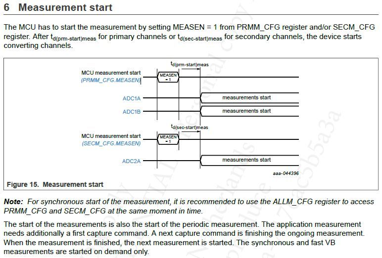

Hello community,
I want to use MC33774 to monitor the battery cell status, and I already have the file MC33774A Data sheet (0.1). I would like to ask some questions, please.
In ALLM_ In the CFG register, the value of bit 0 MEASEN is 0. Will writing 1 make it impossible to measure or meaningless?
The reset value of MEASEN is also 0. Can I not write value to ALLM_ In the CFG register always and IC automatically run with this register default values?
Additionally, I feel that the bit of the BALPAUSELEN signal is written incorrectly, it should be bit2, and bit15:2 should be reserved.

Please see the info below about the usage of ALLM registers.
From the AN12913 (MC33775A and MC33774A measurement):
From the MC33774 datasheet:
Using the ALLM registers results not only in fewer write commands, but also ensures synchronicity between the measurement chains.
So if you set the MEASEN bit in the ALLM_CFG register, the MEASEN bit in both the PRMM_CFG and SECM_CFG registers will be set at the same time and the data acquisition enabled.
The same applies to the BALPAUSELEN[15:2] bits.

TomasVaverka
I am not sure I fully understand your question.
First off, I would recommend you to download the latest (Rev. 1) MC33774A datasheet which is classified as a Secure file requiring an NDA.
Regarding the MEASEN bit, please see below.
As for the BALPAUSELEN [15:2] bits, please see below.
BR, Tomas

TomasVaverka
BR, Tomas
