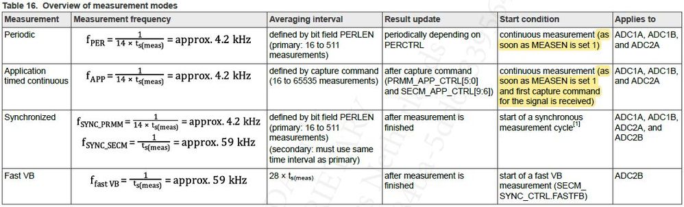

I am not sure I fully understand your question.

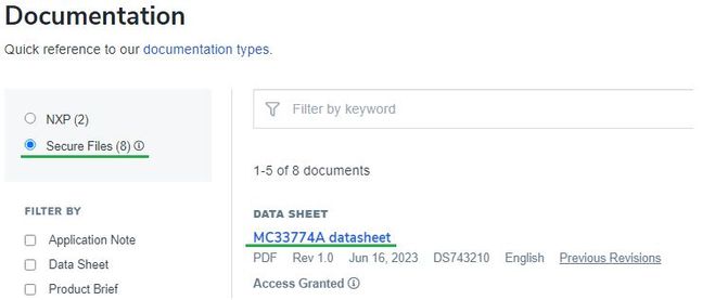

First off, I would recommend you to download the latest (Rev. 1) MC33774A datasheet which is classified as a Secure file requiring an NDA.
Regarding the MEASEN bit, please see below.

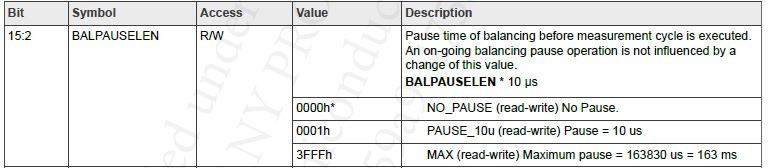

As for the BALPAUSELEN [15:2] bits, please see below.

YangHF
Hi Tomas,
I have downloaded 33774 datasheetV1.0. In the screenshot below, the value of "MEASEN" is oniy "0". Can I set "MEASEN" to "1"? What will be the result of this?And  the "BALPAUSELEN" in the screenshot is not described in detail. Does it have the same meaning as the "BALPAUSELEN" you replied to me on Wednesday?

TomasVaverka
Please see the info below about the usage of ALLM registers.
From the AN12913 (MC33775A and MC33774A measurement):
From the MC33774 datasheet:
Using the ALLM registers results not only in fewer write commands, but also ensures synchronicity between the measurement chains.
So if you set the MEASEN bit in the ALLM_CFG register, the MEASEN bit in both the PRMM_CFG and SECM_CFG registers will be set at the same time and the data acquisition enabled.
The same applies to the BALPAUSELEN[15:2] bits.
BR, Tomas

YangHF
Hi Tomas,
I'm very sorry to bother you again. I didn't find the latest version date sheet. Can you give me a website address to get this document? I will check my NDA level. Thank you!
Best wishes!
6,648 Views
TomasVaverka
The MC33774A datasheet (Rev. 1) is available under Secure Files on the following website:
https://www.nxp.com/products/power-management/battery-management/battery-cell-controllers/18-channel...
Please make sure you are signed in to nxp.com. If you do not see the MC33774A datasheet, please click on "Request additional access" or edit your secure access rights by going to My NXP > Profile.
For more information about secure access rights, please refer to this website:
https://www.nxp.com/support/support/secure-access-rights:SEC-ACCESS
BR, Tomas
