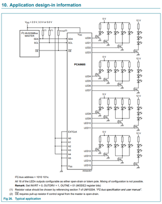

"PCA9685 16-channel, 12-bit PWM Fm+ I2C-bus LED controller" is the product I've been looking into, but I couldn't find any Python code to directly control this product. My plan is to use a USB to I2C converter cable to connect the USB port on my computer directly to the PCA9685 servo controller board. I'd like someone to assist me by providing a simple piece of code to start and stop the servo, or to provide relevant operational information.

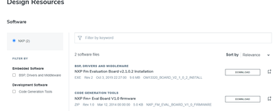

unfortunately we do not use python. Usually our software is in C. Easiest for you would be to purchase OM13320 and use the software on the OM13320 product page

in case you want to use your own software (IDE, code), you need a Master MCU with an I2C interface, which will communicate with your PC and will load your code (set the internal registers) in the PCA9685. Please refer to the Figure 26. in the PCA9685 datasheet.
You also need to set the I2C address with the A0 through A5 pins, and then you need to set the correct address in your code.
