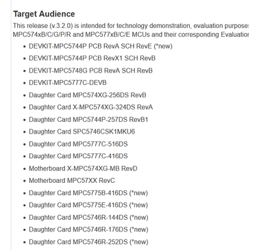

I am planning to purchase the MTRCKTDPS5643L motor control development kit for dual-motors (PMSM) application.
Before placing an order, just would like to understand if this DevKit could work with MathWorks/Simulink ASW development or only design for C-source code development.
I have been searching for it, but still unclear.
Some information on the MathWorks hardware support website (Model Based Design Toolbox), it does not mention anything for this DevKit.

No, we currently does not have.
There will be one at end of 2023 released based on S32K396.

I do not see it is supporting the SPC5643L device at all.
Here is the list of supported MPC5xxx
Secondly I would not use old devices like SPC5643L for new designs.
I recommend to use at least SPC574xP or the latest motor control replacement S32K396 device. Since those has a lot of support tools and will make your development easier.
Peter

Sorry, I should have explained my question clearly, and you are correct that MATLAB Coder, Simulink Coder, and Embedded Coder and support packages are available
 However, NXP Model-Based Design Toolbox support seems not to include MPC56xx?
6,654 Views
petervlna
Yes that would be the case. As the MDBT came in time when MPC56xx where already replaced by MPC57xx.
