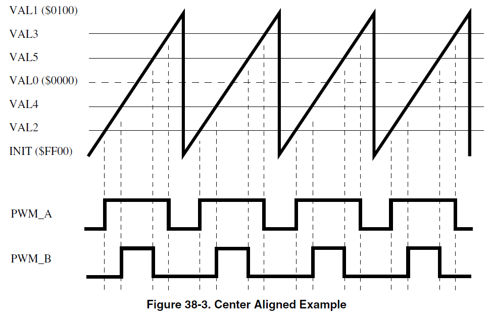

Now I have one question to the timing in the Reference Manual.
In my opinion one PWM period is from INIT to VAL1.
This would mean that with a duty cycle of 50 percent the on time starts at INIT and ends at VAL0 ?
So for starting the adc conversation at each on time from the PWM I have to set VAL1 ?
Or at which VAL starts the duty cyle ? I think testing this should be possible with the example "kv4xf_eflexpwm_isr" ?
So the PWM_A and PWM_B above are only the timers and not the configured output pins in the block you can see in the picture blow. Is that correct so far ?

Like you explained in Module 6: Current Sensing the sensing must be at the time where the Low-Side IGBT is on.
At the moment I trigger the ADC with the PWM command at VAL0 (the middle of PWM_A).
If I'm right the picture shows PWM_A high side IGBT ??
So instead of this I should better trigger the ADC with VAL1, which in complementary PWM mode should be the middle of the on state of the low side IGBT  ?
Indeed the PWM Counter starts at INIT and rolls over at VAL1 measuring the one PWM period.
The diagram you are referring to represent the "center aligned" PWM generation when the PWM high and low are aligned in the center to the VAL0.
Your description is valid for edge-aligned PWM generation.
It depends on with VALx you choose as Output trigger. If you select VAL1 then YES, the ADC conversion will start when FTM counter value = VAL1 (end of PWM period in this particular case)

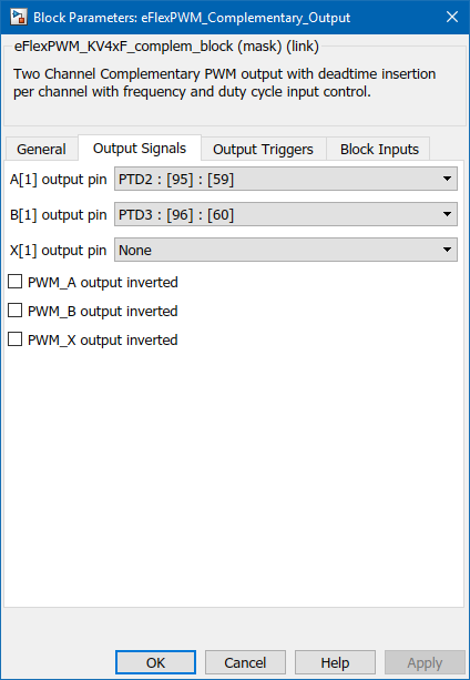

No, that PWM_A and PWM_B are the actual PWM signals that drives the power transitors. PWM_A = A[1] output pin and PWM_B = B[1] output pin.

Ok,
if I'm right the image above from the reference Manual is only a example for the generated Output signals and are independant.
In case of Center aligned and complementary Output the signals from PWM_A and PWM_B would be like this ?
So for starting the ADC conversation with the rising edge of PWM_A I have to choose VAL2 ?
The Options center aligned, edge alligned or assymetrical I can only find in the "Independant PWM output block".
But I want to use the "Complementary eFlexPWM output block" or the "Three-phase eFlexPWM output block".
So what kind of output signal is generated from These two blocks ?

For the Complementary and 3-Phase eFlexPWM blocks the PWM generation mode is hardcoded - "CENTER ALIGNED" type.
As a hint: you can try to build a small demo model, compile it an check the generated code for pwma_sub_module_pwm_param_t structure initialization. All the generated code is based on the Kinetis SDK drivers, therefore you could use SDK documentation as resource.
