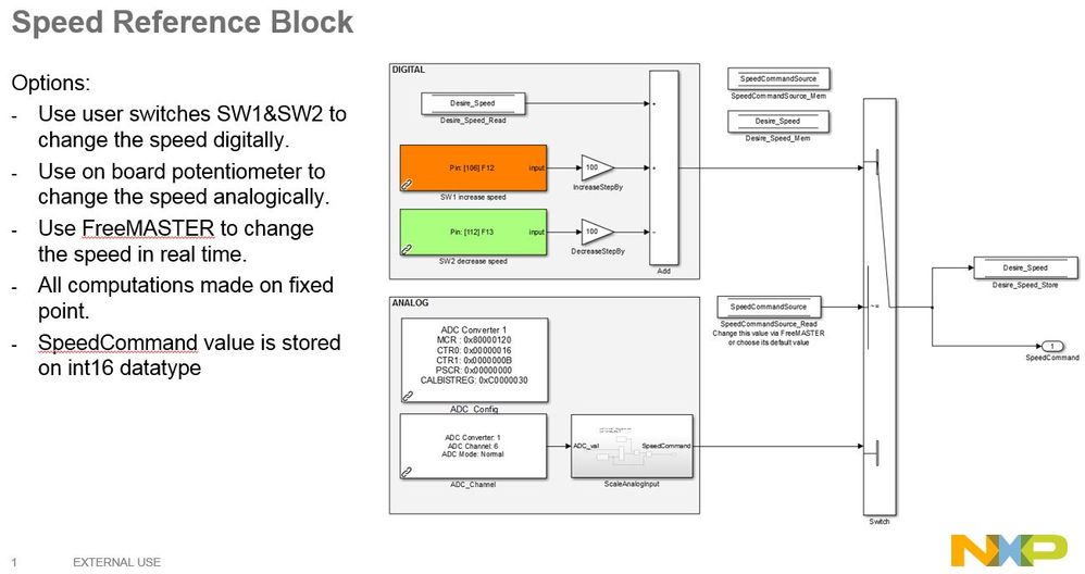

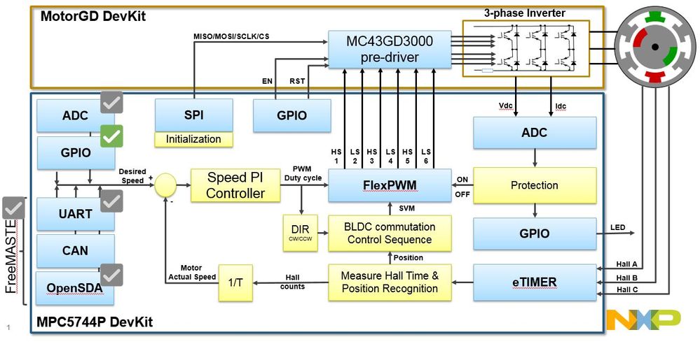

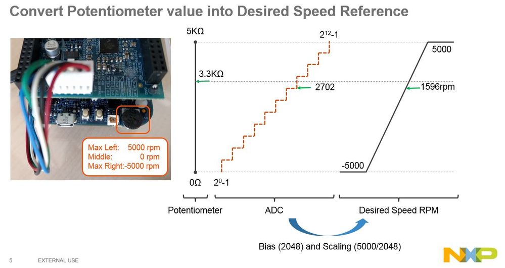

In this third lecture of the motor control course we discuss about how we can read different analog or digital inputs to build a speed reference block generator in Simulink model that will set the desired speed command for the PI speed controller.
Main topics:

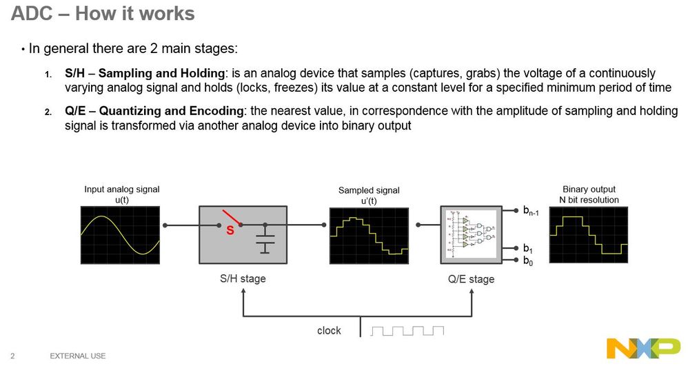

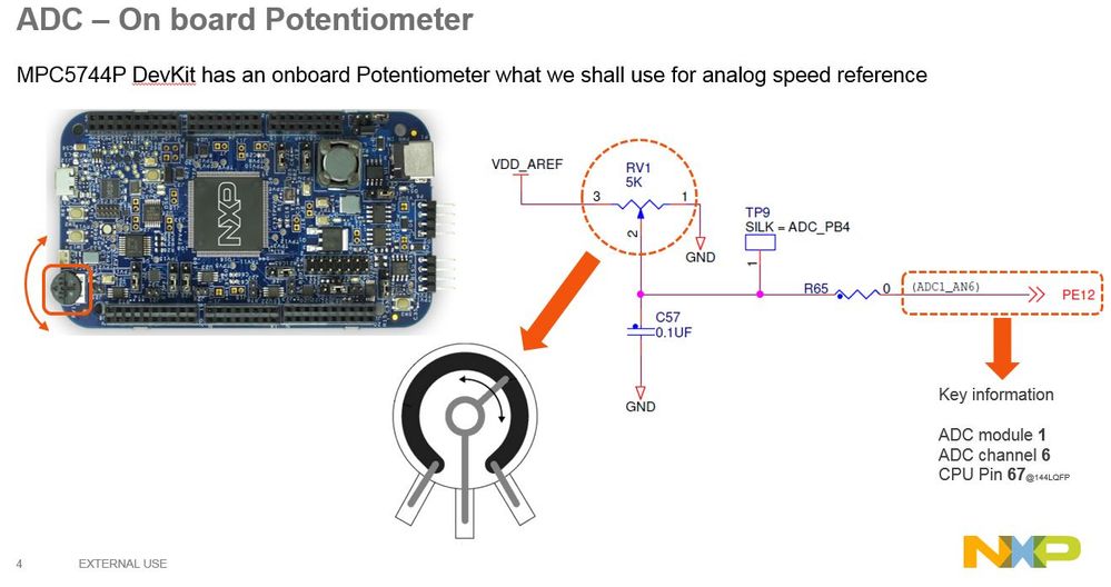

    - How ADC works;
    - How to build an application around ADC peripheral;
    - How to flash the application on the target microprocessor;

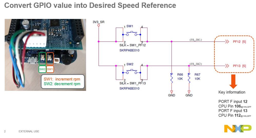

    - How to build an application around the GPIO peripheral;
    - How to use the FreeMASTER to test applications in real time;
    - Mixing ADC and GPIO model into a single reference speed block;

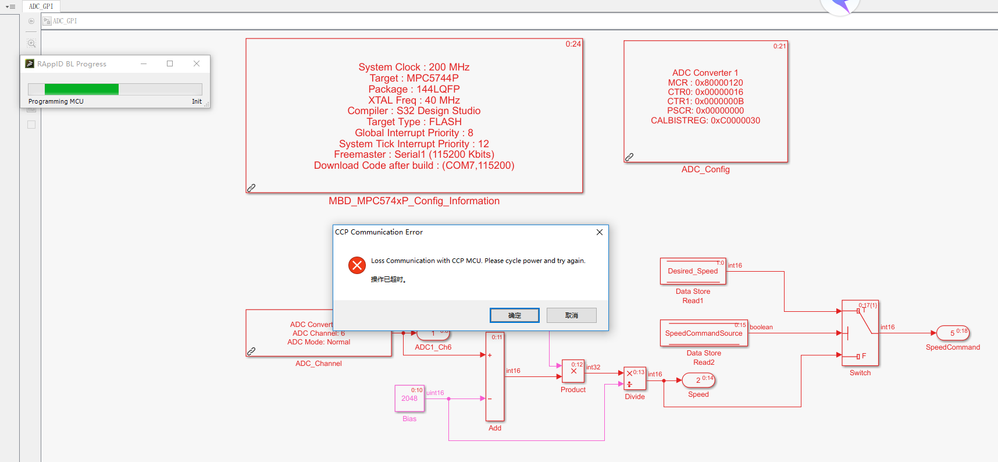

Hi, Daniel. Today, when I tired to download the program from SIMULINK, the following problem was encountered, which said, "Loss Communication with CCP MCU. Please cycle power and try again". I'm wondering if there are problems with my hardware or some other problems. Days before, the procedure went well. But today, the communication cannot be established. Can you offer some help? Thank you.
47,568 Views
constantinrazva
Hello [email protected]‌,
If it worked earlier and it no longer does, I'd check to see if the board is still on COM7. If it is and it still does not work, you can try and download a simple example from SDK using S32Design Studio, to make sure the board is ok.
Please let me know if it works or what fails.
Kind regards,
Razvan.

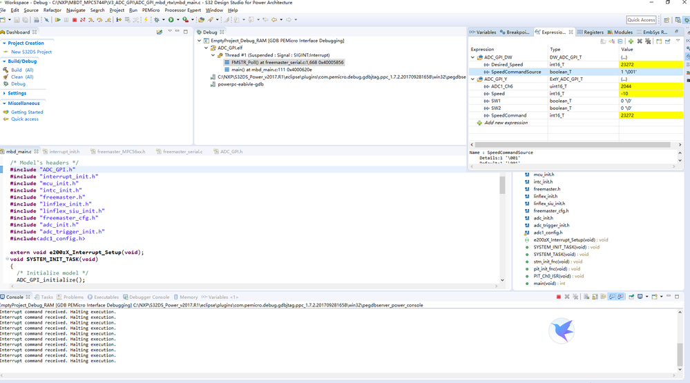

47,565 Views
hc17
Hi, Razvan. Still haven't found the problem why the communication cannot be established. But I find the problem why the result was not multiples of 100, just because the program run too fast so that an overflow occurred. :smileyhappy:
Kind regards,
Chao
47,568 Views
hc17
Hi, Razvan. Thanks for your reply. It works fine when I download the '.elf' file generated by SIMULINK using S32DS. But there seems to be something wrong when debugging using S32DS, where the variable 'SpeedCommand'  should be multiples of 100, just as the lecture indicated. The result was right in FreeMASTER yesterday.

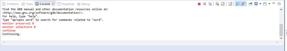

mahdkhalid
Hi Daniel,
No I am not using both in the same time. I follow the steps of the video where I first load the bootloader and then open FreeMaster. When I press debug I see the following message on the console and when I open FreeMaster and use the simulink elf file it does not communicate with the board.
Message on console after running debug^
Mahd

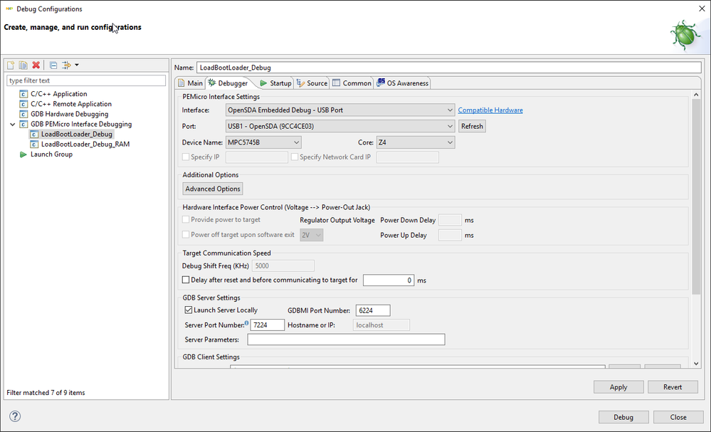

mahdkhalid
Hi Daniel, Thank you for your reply.
I have rechecked the cable and the jumper configurations they seem to be correct. I am attaching the screenshots. There is one difference in my Debugger console which I have attached as well. I would be grateful for any helpSimulink settings.pngPorts.pngDebug Settings.pngError on debugger.png
Mahd
47,569 Views
Daniel_Popa
Hi Mahd,
I'm not sure i understand. You said that the FreeMASTER can't connect and hence you show me a screenshot of S32 Design Studio. Are you trying to access the target via OpenSDA from both FreeMASTER and S32DS in the same time ? That would not work since the UART can't be shared across the multiple processes.

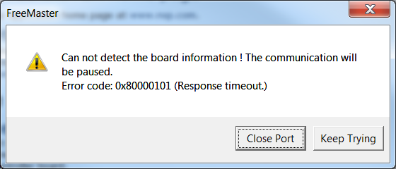

mahdkhalid
Hi, I have tried this tutorial thrice now for some reason my FreeMaster gives the following error
"Can not detect the board information the communication will be paused"
Error code: 0x80000101(Response timeout.)
47,569 Views
Daniel_Popa
Hi mahdkhalid‌,
I'm sorry to hear that. In case you got this message:
there are a few potential problems:
- wrong PORTxxx configuration in the FreeMASTER
- cable not connected over the microUSB
- wrong settings for FreeMASTER in the Simulink model
- wrong jumper configuration on the board that does not power on the board.
Can you attach screenshots with your Simulink FreeMASTER configuration, FreeMASTER communication configuration and your PC Device Manager /Ports when the MPC5744P is powered on ?
Thank you!

Q1: Can you change the model to start with at 500 rpm speed reference after reset ?
A1: The Simulink Data Memory Store block for Desire_Speed initial value needs to be changes for 1000 -> 500

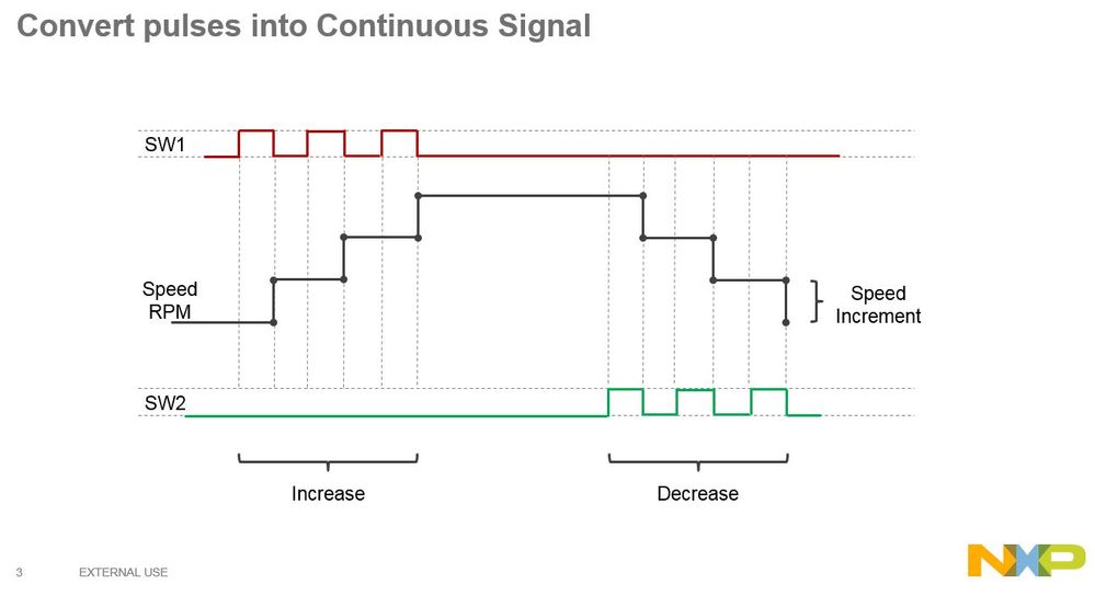

Q2: To operate smooth in any conditions – the model needs an additional block. What would that be ?
A2: If one is going to analyse the model of the reference command, will see that when operation over the GPIO (push buttons to increase/decrease the command speed) the reference is given in steps. This is going to introduce a perturbation in the system that will force the speed control to follow a sudden change in reference. Ideally we need to give that command as a ramp/slope from the old value to the newest one in order not to stress the controller. This might be implemented with a dedicated RAMP block from AMMCLIB or with a simple FIR
Q3: The model hides a design flaw that needs to be address in the future videos. Can you foreseen that issue ?
A3: This is more subtle. In this model there are 2 methods of getting the reference speed: from GPIOs or from ADC. The problem is that GPIO give a incremental command (relative to the last know position) while ADC/Potentiometer give an absolute information.
Within the application we have the capability to switch between these 2 modes of operation by changing on the fly the value of SpeedCommandSource variable with FreeMASTER. Then you do then the reference is switch from one value to the other which might be a very sudden change in direction. This can be addressed in 2 ways:
- allow mode selection only at startup when the motor is not moving
- implement Q2 answer suggestions.
Hope this helps!
