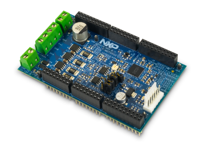

This is a short and simple HOW TO SPIN a motor with NXP's latest development kit: DEVKIT-MOTORGD

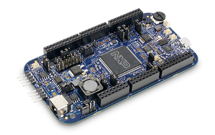

- DEVKIT-MPC5744P development kit based on NXP's Power Architecture technology

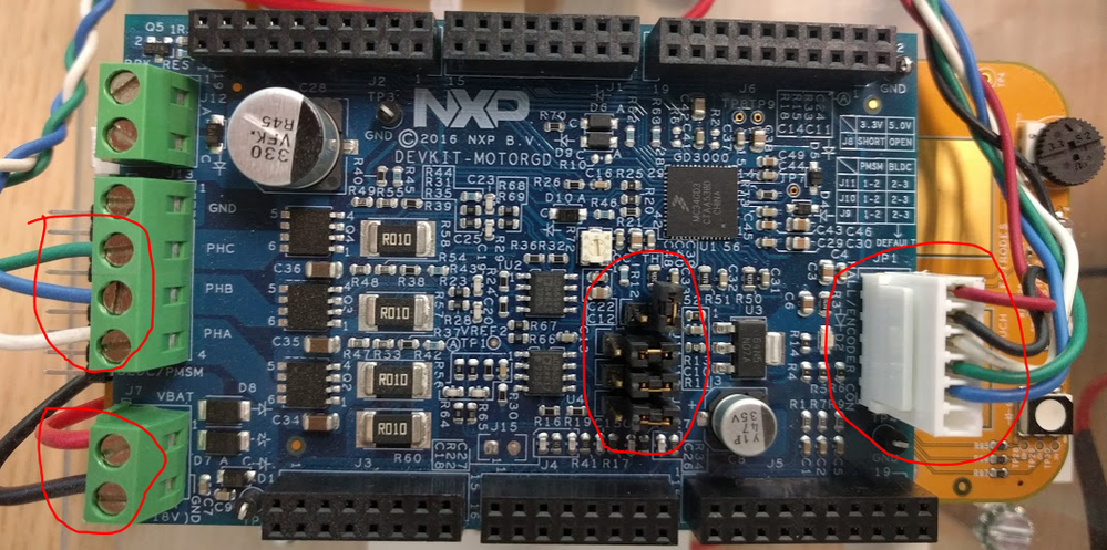

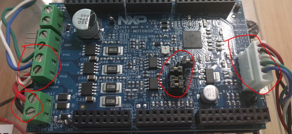

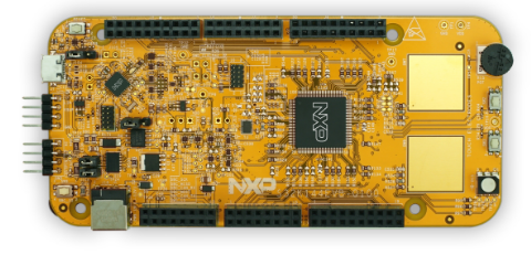

S32K - MOTORGD SETUP

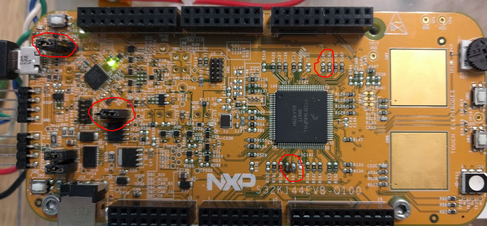

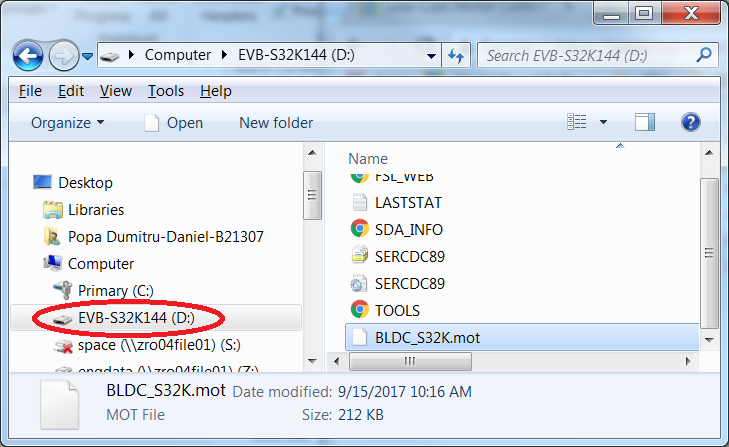

For S32K Setup following are the steps to prepare the S32K144EVB-Q100 to work with DEVKIT-MOTORGD:
  • Place R168 and remove R167
  • Place R166 and remove R165
  • Short 1-2 of J107 (S32K144 powered by 12V power source)
  • Short 2-3 of J104 (Reset signal direct to the MCU, use to reset S32K144)
  • Plug in the microUSB cable between S32K144EVB-Q100 and your PC
  • Copy and Paste the BLDC_S32K.mot file into the EVB-S32K144 Mass Storage Drive mapped on your PC
  • Power up the DEVKIT-MOTORGD via J7 with a 10-18Vdc and you should have the motor spinning

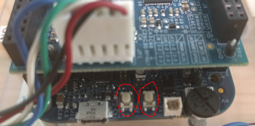

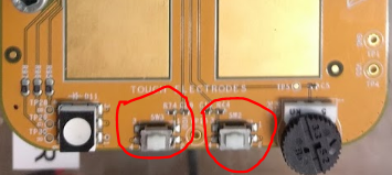

  • Use SW2 to increase the motor speed or SW3 to decrease it or to change direction

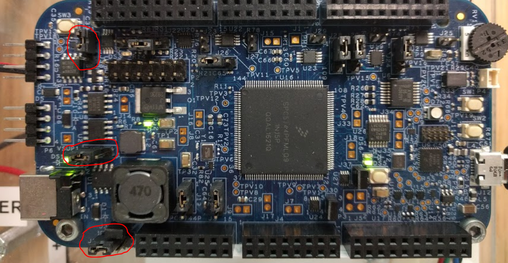

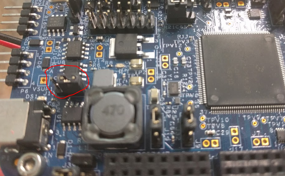

MPC5744 - MOTORGD SETUP
For MPC5744 Setup following are the steps to prepare the DEVKIT-MPC5744P to work with DEVKIT-MOTORGD:

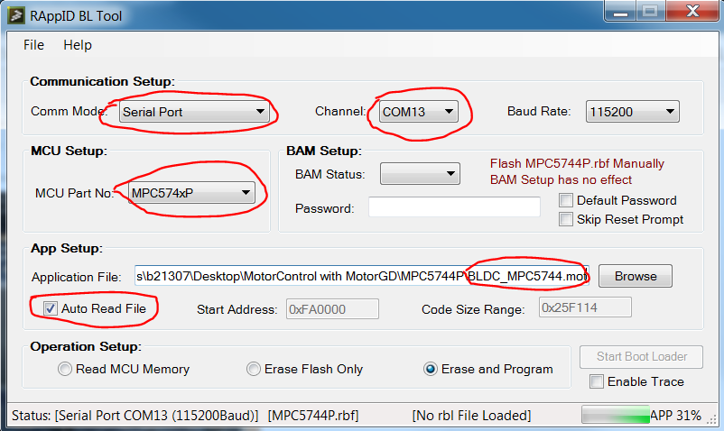

  • Follow the procedure shown here to program the BLDC_MPC5744.mot file into the DEVKIT-MPC5744P
  • After the BLDC_MPC5744.mot file is programmed into the DEVKIT-MPC5744P flash memory, change the J13 to position 1-2 for external power supply.
  • Use SW1 to increase the motor speed or SW2 to decrease it or to change direction

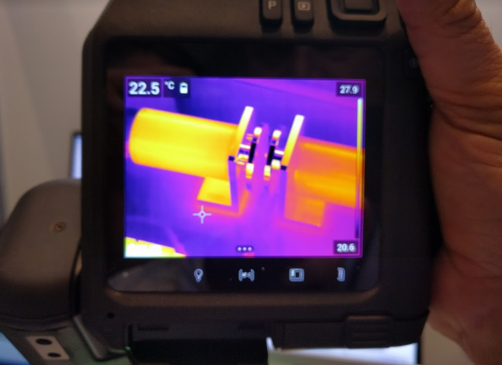

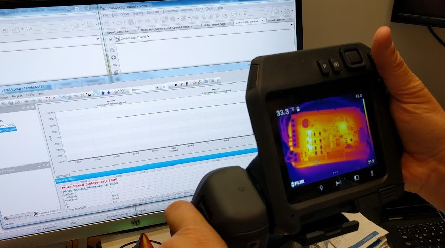

Daniel_Popa
Just recently at MATLAB Expo US we had the chance to inspect the boards with a professional FLIR IR camera. Here are a few interesting snapshots:
Note: the demo runs non-stop all day long. These are the captures at the end of the day. The hottest temperature on the MotorGD recorded was on the MOSFETs: 42 deg C
