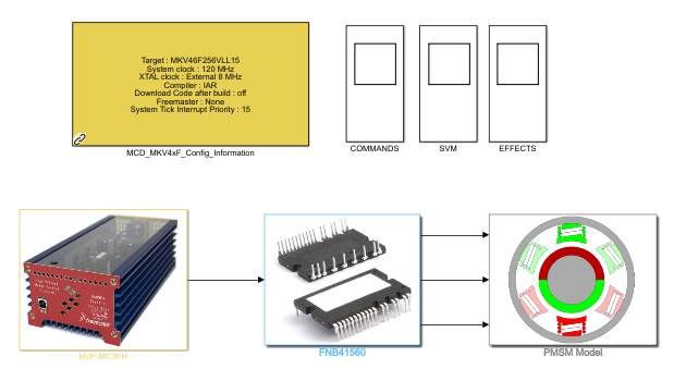

Fig. 4 shows the Simulink model we are going to use for V/F scalar control implementation, testing and validation. The model can be find attached at the end of this article.
Fig. 4: Simulink model for the entire plant: MCU-DC2AC INVERTER-PMSM
The model shown in Fig. 4 consists in three major subsystems that mimics the actual hardware arrangement, each one of them implementing a specific functionality:
  • S32K14x EVB - implements the S32K MCU logic that allows the control algorithm to compute the PWM commands for the power inverter;
  • Motor GD DevKit - implements a simplified model of power inverter that converts the PWM commands into high voltage continuous signals;
  • PMSM Model - implements a simplified PMSM motor model that replicates the behavior for the real LINIX motor.

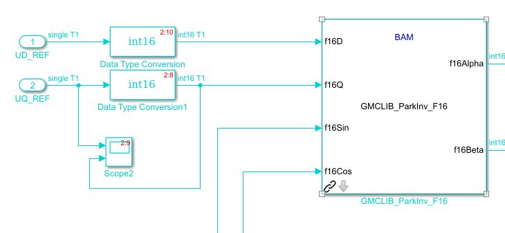

The quadrature voltages alpha-beta are computed based on the electrical angle and the (dq) reference voltages obtained in SLOW Loop. In case of UD_REF the value is set to 0 just to emulate the theory behind FOC and in case of UQ_REF the value is obtained from a Look-Up-Table (LUT) that implement the concept of V/F scalar control.
Fig. 7: FAST control loop model
At each 0.1ms the PWM commands are computed and updated based on AMMCLIB specialized Simulink block that implements and optimized Space Vector Modulation with 3rd harmonic injection. These PWM commands are then passed to the next subsystem that emulates the operations for power inverter.

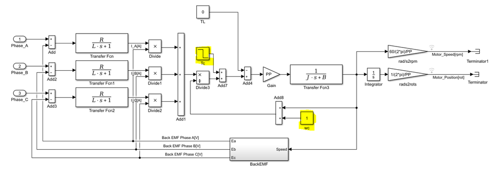

PMSM Model Subsystem
The Simulink model consists in standard 3-phase PMSM motor equations shown in Module 2: PMSM and FOC Theory. Within the model you can easily identify:
  • stator windings electrical model
  • electro-mechanical model
  • sinusoidal back-EMF model
Fig. 9: 3-phase PMSM model
Note 1: we are not going into details about PMSM modelling since this is not the purpose of this module. Feel free to follow the link indicated in the model to get more details. As usual, if you have any questions about it, feel free to ask.

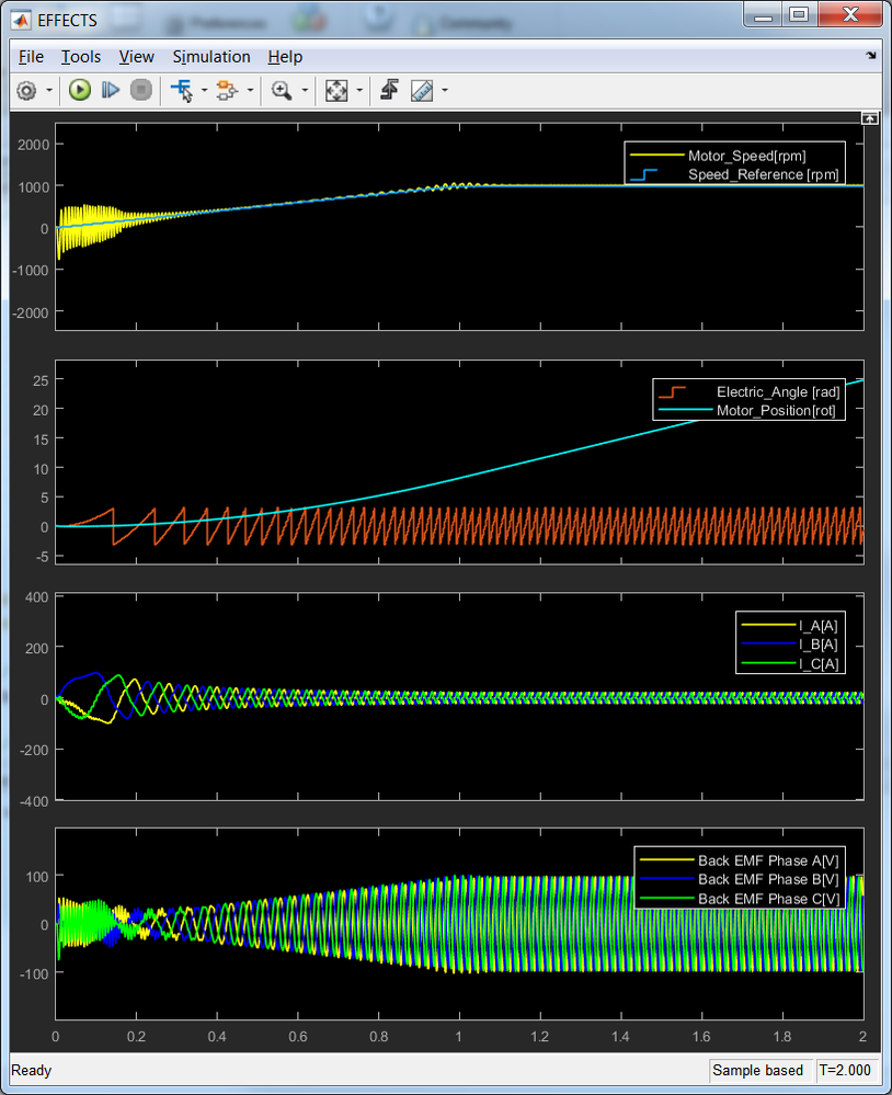

MATLAB SIMULATION OF THE PLANT
The entire V/F scalar control algorithm (...and not only) can be validated using this simulation environment provided in MATLAB/Simulink. This way we can validate the Space Vector Modulation, V/f scalar control and PMSM motor dynamic responses even without having the actual hardware setup. For those of you planning to use NXP hardware in the future, this approach might be useful in getting familiar with motor control.

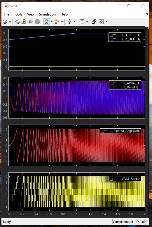

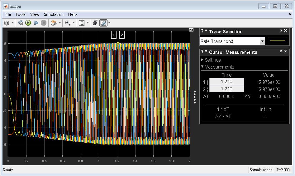

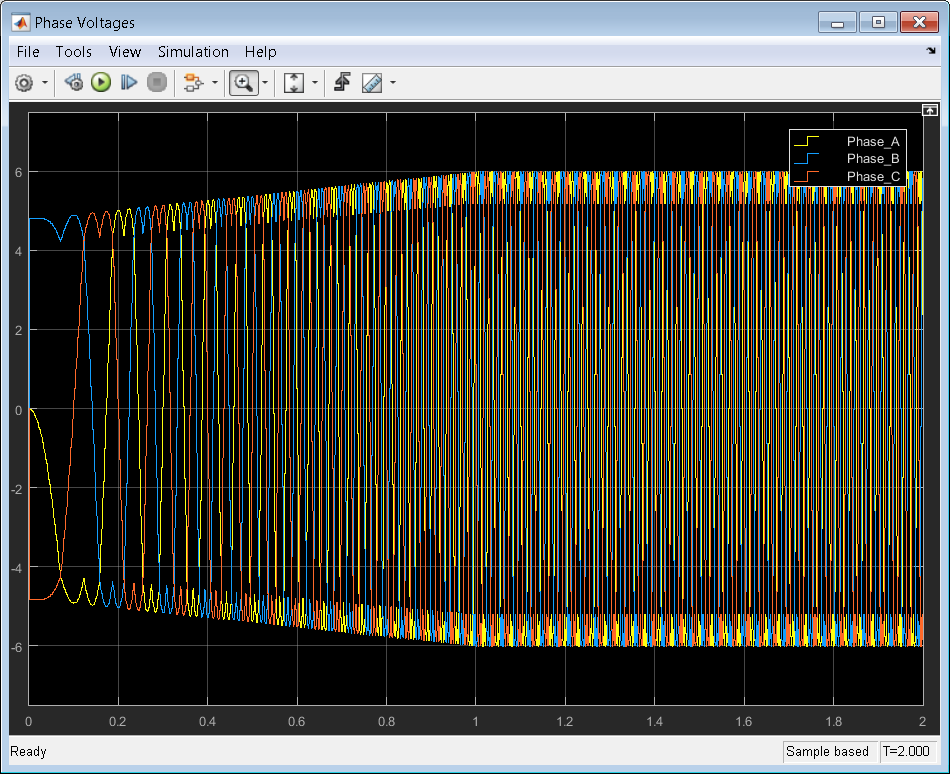

Fig. 10, 11 and 12 show the main control signals and outputs for each subsystems discussed earlier. At this point we can investigate various quantities that might not be easily accessible on the real plant.
Fig. 10: V/F scalar control commands in case of start-up ramp:
(1) Speed Profile, (2) Electric Angle, (3) quadrature voltage references and (4) 3-phase stator voltages references
Fig. 11: Space Vector Modulation verification: Inputs & Outputs
Fig. 12: PMSM Model Responses in case of start-up sequence:
(1) Command vs. Actual Motor Speed, (2) Rotor angle vs. Rotor position, (3) Stator Currents and (4) Back EMF voltages
As can be seen there is a good match between the results obtained in simulation and the PMSM motor theory. Now that we have built confidence in the results it's time to move on to next stage.

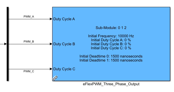

The most important aspect of the whole application is to be able to generate the PWM signals based on the Space Vector Modulation technique and pass these signals to MC34GD3000 pre-driver. NXP's Model-Based Design Toolbox for S32K1xx address this issue in a very simple and convenient way by providing a S32K dedicated peripheral block for FTM as shown in Fig. 1
Fig. 17: PWM generation in Simulink modelling vs. PWM generation used for code generation on S32K
The FTM Simulink block is configured to initialize the FTM3 module since the output signals from that specific module are routed on the PCB to control the actual power inverter MOSFETs. The schematic for the MotorGD DevKit Fig. 18, shows the actual signal routing.
The MotorGD DevKit was designed to be compatible with Arduino shields, therefore only some specific signals are available on the pin-headers. In case you design your own power inverter you might need to reconfigure the actual pins that controls the MOSFETs.
Fig. 18: MC34GD3000 and MotorGD DevKit Power Inverter signal routing
Based on the pins assignment on both MotorGD DevKit Fig. 19 and S32K14x EVB  Fig. 20, we can configure the actual FTM peripheral as shown in Fig. 21.
Fig. 19: MotorGD DevKit Pin Assignment
Fig. 20: S32K144 Evaluation Board Pin Assignment
Fig. 21: FTM Peripheral Block Configuration for controlling the power inverter from MotorGD DevKit

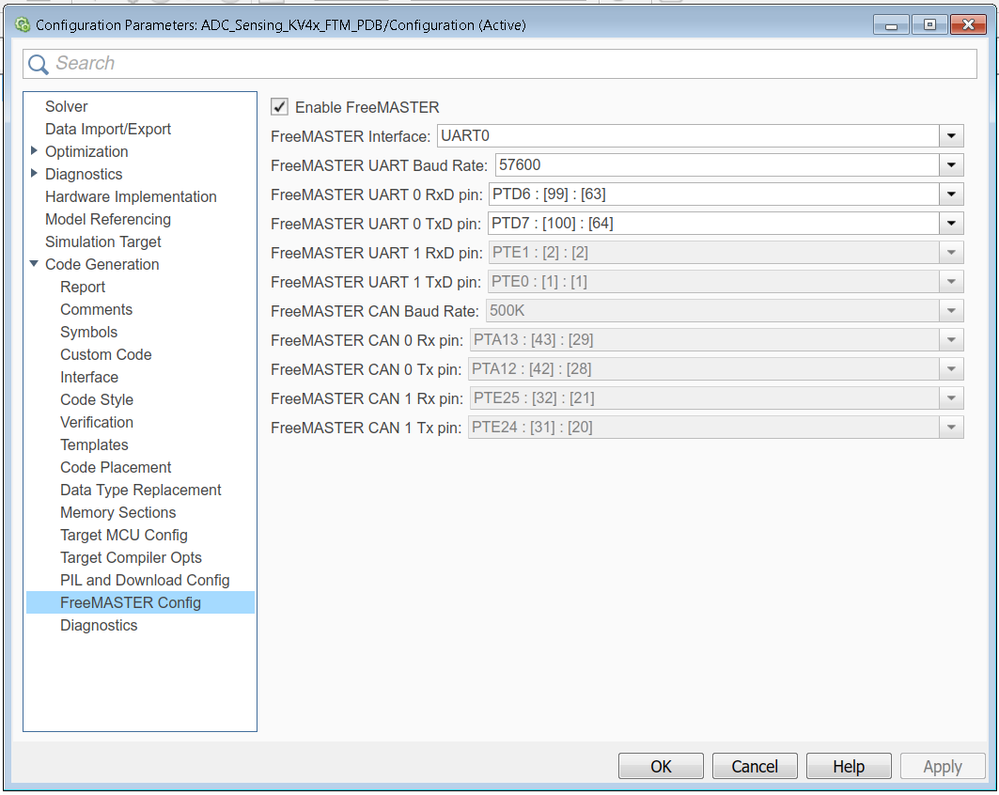

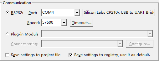

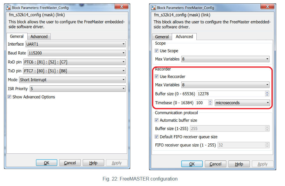

FreeMASTER Support for Data Visualization
Before generating the C-code for the application and deployment on the hardware, we need to enable and configure the FreeMASTER embedded driver to allow us the visualize the data in real time. Since most critical part of the V/F control algorithm is done in the FAST loop that is executed at each 0.1ms, we will need to configure the FreeMASTER to capture the data in that specific routine.

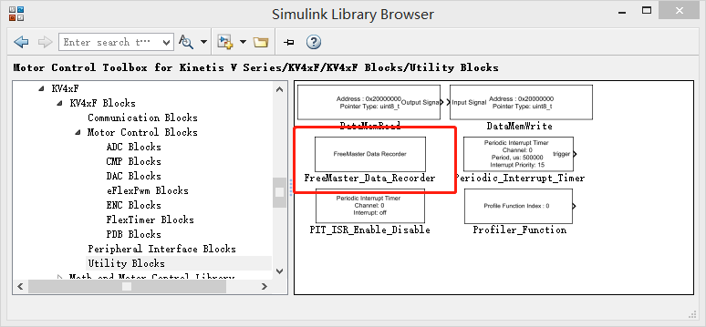

NXP's Model-Based Design Toolbox lets you configure and call the FreeMASTER anywhere in your model. For this application, since the goal is to check the real hardware data against the ones obtained from Simulink simulation we are going to configure the FreeMASTER as shown in Fig. 22.
Fig. 22: FreeMASTER configuration
Please note that we have configured the FreeMASTER to work in Short Interrupt mode, with a relative high priority - less than the ones needed for actual motor control loops and we have enabled the Recorder option for a timebase of 0.1ms. All these settings and the actual function call for the FreeMASTER Recorder (Fig. 23) are needed to make sure you capture the data in the FAST loop - otherwise we might read wrong data.
Fig. 23: Place the FreeMASTER Recorder Call Simulink Block in the FAST Loop Sybsystem

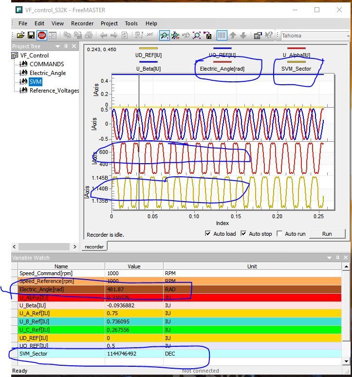

At this point we can run the application on the embedded side and verify the results against the ones obtained in simulation. Since we want to verify the algorithm behavior prior to running the actual motor, then for these kind of tests, we do not have to power on the MotorGD DevKit. This verification step can be done using PIL co-simulation as well but for getting closer to the final application setup, I've choose to run the application completely independent of MATLAB environment. In this case the real time data from S32K are obtained and visualized via FreeMASTER in RECORDER mode. The FreeMASTER project used in conjunction with Simulink model shown in Fig. 13 is attached at the end of the article.

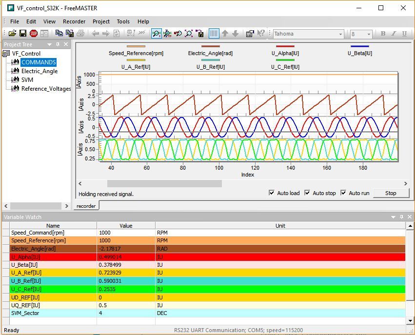

First, we will check the correct generation of the commands for SVM and the PWM duty cycles waveforms associated with these commands. In the next figures, on the left hand side we can see the waveforms generated with MATLAB/Simulink environment in SIMULATION mode while on the right hand side the same data are RECORDED with FreeMASTER on real hardware S32K MCU for the same scenario. As you can see there is a remarkable similarities between these sets of data, giving us confidence that once the PMSM will be connected the motor will behave as predicted in SIMULATION environment.
Fig. 24: SIMULATION vs. REAL Start-up Sequence
(1) Speed Reference Profile, (2)Electric Angle Transformation, (3) Fixed Frame Quadrature Voltages,
(4) 3-phase PWM duty-cycles for each PMSM phase
Fig. 25: SIMULATION vs. REAL Space Vector Modulation in Steady State Regime
Inputs: (1) DQ Frame Voltages, (2) Fixed Frame Quadrature voltages, (3) Electric Angle for 500[rpm] equivalent
Output: (4) SVM Sector Identification
Fig. 26: SIMULATION vs. REAL PMSM Steady State Zoom
(1) Electric angle variation for 500[rpm] motor speed and equivalent (2) SVM 3-phase voltage references

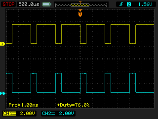

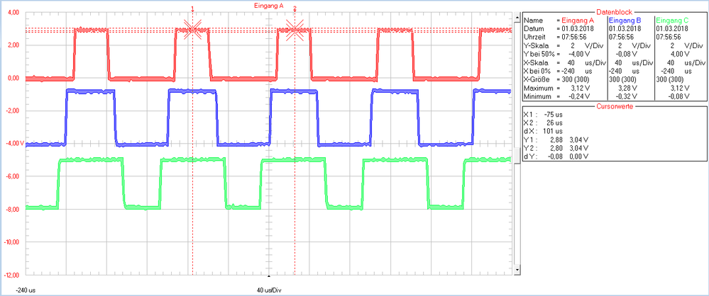

We start with PWM signal generation. The scope of this verification is to check the correct waveform generation (polarity and frequency) and signal integrity (rising/falling slopes, signal levels, dead-time). For this test we are going to use an oscilloscope to scope the digital signals directly on MotorGD DevKit PCB.
Fig. 27: PWM High (yellow) and Low (cyan) Commands
Note PWM HIGH and LOW are configured to be complementary but due to HW restrictions the low side PWM signals are active LOW.
As can be seen in Fig. 27, the PWM signal generation is done correctly with 10KHz frequency and correct polarities based on the settings from Fig. 21.

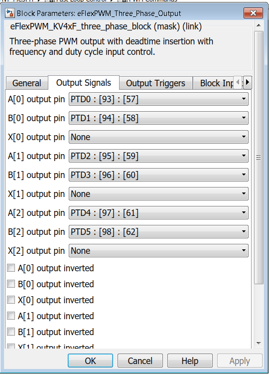

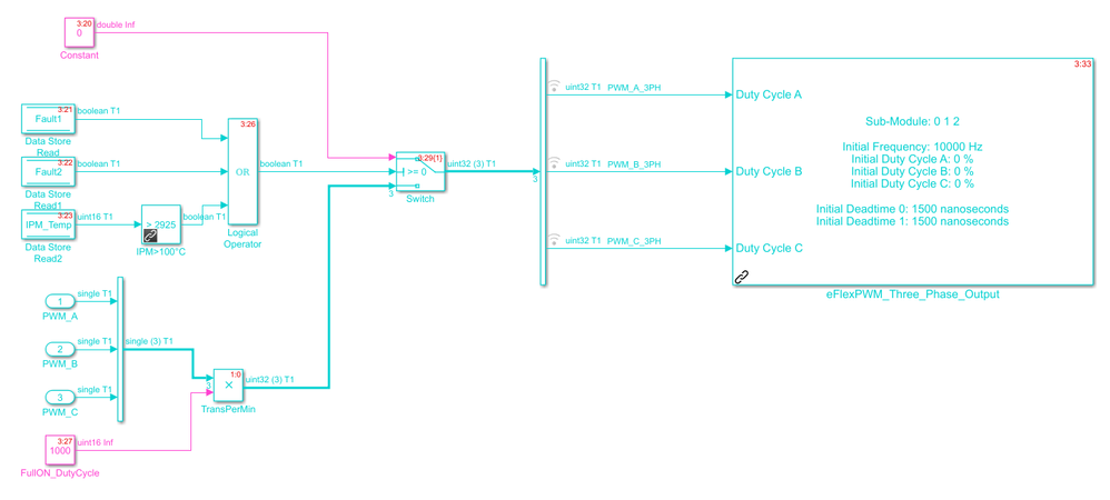

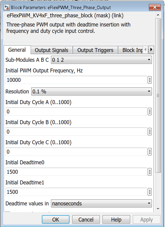

I think mariuslucianandrei‌ can explain better than me the functionality of the PWM block, but let me give it a try.
Initially, when we have started this lecture, we had to do a special PWM switching signal routine at startup to initialize the MOSFET predriver operations (load the boot strap capacitor). At that point the initialization sequence requires that each PWM pin must be controlled independent of each other (you can check the MC34GD3000 manual)
Since the toolbox do not allow you to reconfigure the PWM at runtime - i had to implement the example using independent so that it could work in both scenarios (init + normal op)
Of course, if you do not use the NXP predriver - then you could use complementary mode too. Furthermore, in the latest release of the S32K MBDT there is a special block that handles the configuration of the pre-driver hence the model could be potentially improved to use only complementary.

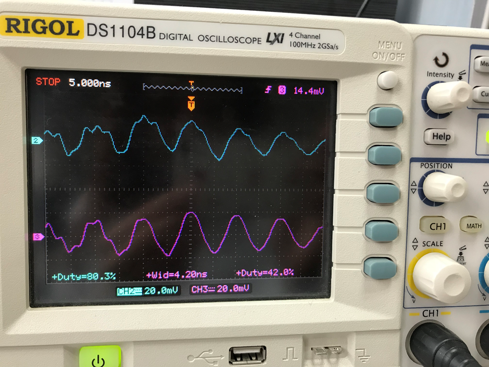

How do you Introducing Deadtime between Mosfet Switching? beacause in FTM PWM Configuration you select Deadtime=0 ticks.
Since we are using standard C-functions from the NXP SDK, we are bound to implement the functionality according with the API.
In the independent mode, there is no settings for the deadtime since you have full control of the PWM waveforms. In the model the deadtime is added from the SPI initializations done for the predriver. The MC34GD3000 can insert the deadtime by itself to ensure the signal integrity.
is there any relation of all this settings with PWM_LOGIC subsystem which contain Driver Initialization routine
can you please give detail of how do you generate Complementary signal with Dead time with reference to attached Model.
The model is already prepared for complementary mode. If you check the inputs for the PWM are simply duplicated at the input.
My suggestion is to use and oscilloscope, disconnect the motor lines and the Vdc and check the actual signal after you have switched to complementary to make sure the signals are generated correctly.
Hope this helps!

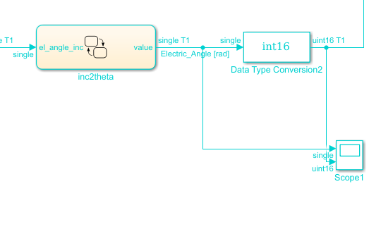

yongcheolshin
Hi ! dumitru-daniel.popa.
Thank you for your Motor Control Workshop with MBDT.
This workshop is very useful for the engineers who want to know Motor control.

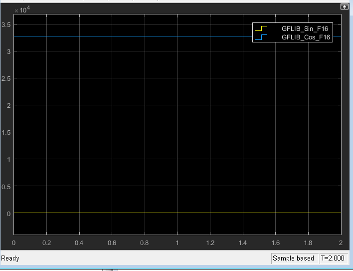

I have a problem when I try to execute FreeMaster to simulate V/F control.
I am using MATLAB 2017b version and Model-Based Design Toolbox for S32K1xx Series 2018.R1 (R2016b-R2018a) 23-Jul-2018.
Below are the images of Simulink  and FreeMaster for the V/F control using your M5 zip file.

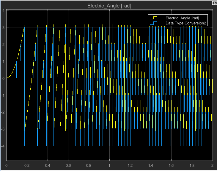

          < FreeMaster Image>
If you look at FreeMaster images, Electric Angle and SVM_Sector waveforms are different from the
simulink waveforms. These are not the waveforms and data that I expected.
May be this problem come from new version of MBDT or others.
Could you help me?
15,962 Views

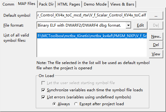

yongcheolshin

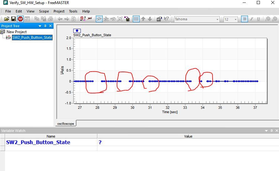

And I aslo have same problem about M1 Verification simulation sample.
I am using below MTRDEVSPNK144kit
Look at FreeMaster variable watch window , it only displays " ? "
no values are displayed in the graph?
I think simulink FreeMaster Configuration block may have errors.
I attached my zip files that is used in this simulation.
I hope your reply, thank you
15,953 Views

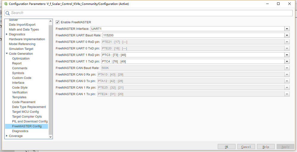

Daniel_Popa
Sorry for delay. It seems that for older threads we do not get correct notification when someone adds a comment. Perhaps it would be better to start a new discussion if you do not get an answers with 24h.
Can you please increase the FreeMASTER interrupt priority in the FreeMASTER configuration block? Is the issue still reproducible?
Thank you!

lethuer
Contributor V
Hi dumitru-daniel.popa‌
I had a look in your simulink pmsm model and don't understand the Tc and wc constants.
I searched in your link but didn't found them
https://www.intechopen.com/books/matlab-a-fundamental-tool-for-scientific-computing-and-engineering-...
Chapter 14
Could you explain them ?
Leon

Daniel_Popa
Hi Leon,
In the PMSM Simulink model provided in M5 support package, the back-EMF constant KV is expressed in weber [Wb] as derived SI unit.
So, lets consider KV = 0.00215306398564147[Wb] is just KV = 0.00215[Wb] = 0.00215[Vs] (same thing but in a different SI)
Now, you want to transform the [Vs] -> [V/rpm] - lets see the procedure:
#1: divide [Vs] to radians in order to get the magnetic flux relative to position [Vs/rad]
#2: rearrange the fraction in order to highlight the speed (rad/s) at the denominator : [V/(rad/s)]
#3: transform (rad/s) -> (rpm): 1 [rpm] = 0.104719755 [rad/s]
#4: transform [V/(rad/s)] into [V/rpm]: 0.00215[V/(rad/s) = 0.00215*0.104719755[V/rpm] -> KV = 0.000225[V/rpm]
#5: @1000rpm electrical speed the induced back-EMF: e = KV * 1000[rpm] = 0.000225[V/rpm]*1000[rpm] = 0.2251[V] @1000rpm
Note that i'm using the 1000 rpm electrical speed - since we have to think everything in mathematical form used by motor equations.
If you want to transform in mechanical speed then simply multiply the #5 result with the number of pole pairs. In case of the model we have pp =2 and the get an induced back-emf e=0.4503[V] @1000rpm_mec
The value 0.4503[V] @1000rpm is right about there if we run the model.
Hope this helps!

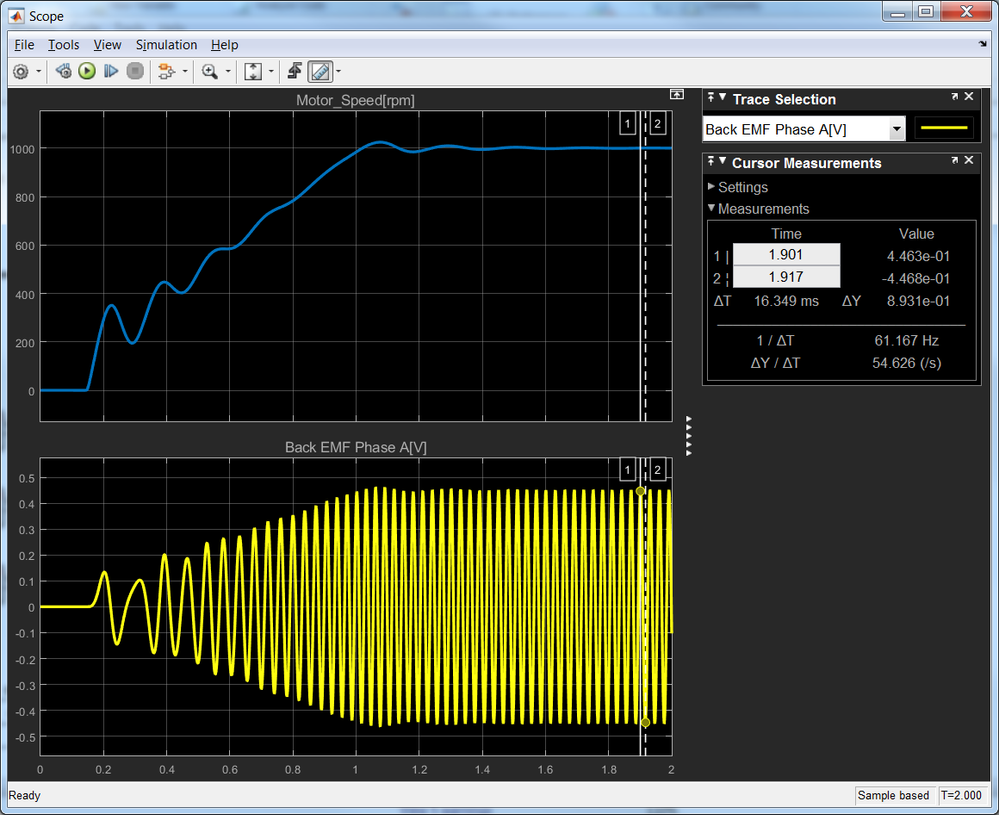

lethuer
Contributor V
so now I'm able to simulate something !
In my case the induced back emf is KV(rms) = 0,0230 V / rpm
Your Back emf constant is given in the peak, so: KV(Peak) = 0,0230 V / rpm * sqrt(2) = 0.0325 V / rpm
Now I have to convert V / rpm in V / rad/s
KV(Peak) = 0.0325/((2*pi/60)) V / rad/s = 0.310609129074202 Vs / rad = 0.310609129074202 Wb / rad
The result is this with Udc = 325 V.

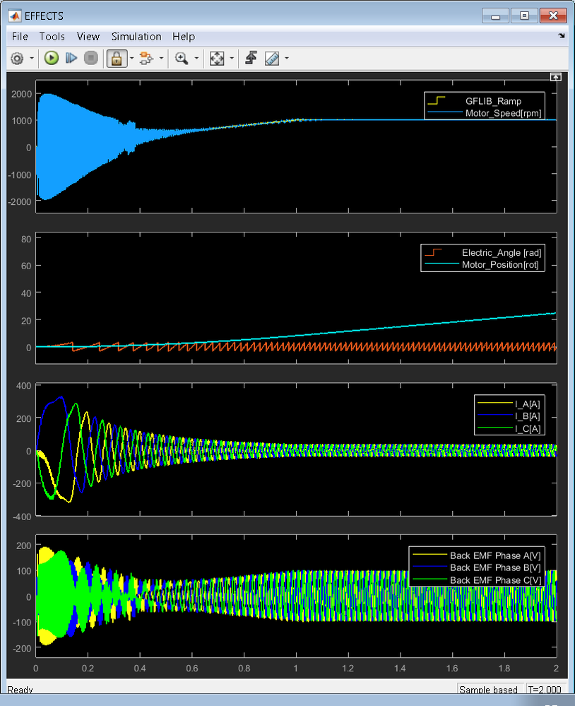

At the beginning we have huge swinging in the Motor Speed, and because of that really big back emf.
The current is far to high. After raching 1000rpm it is still 35 A(peak)
What could I try to optimize the Simulation result ??
Maybe we have to limit the current because our 3-ph Inverter only supports +-8A ??
Only for checking the back emf constant after reaching 1000rpm:
e = 0,0230 V / rpm * sqrt(2) * 1000 * 3 = 97,58 V
Kind regards
Leon
13,645 Views

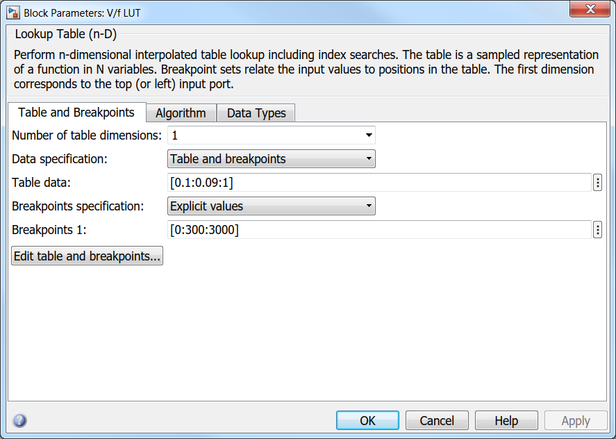

Daniel_Popa
Hi Leon,
It is shown in Fig. 2.

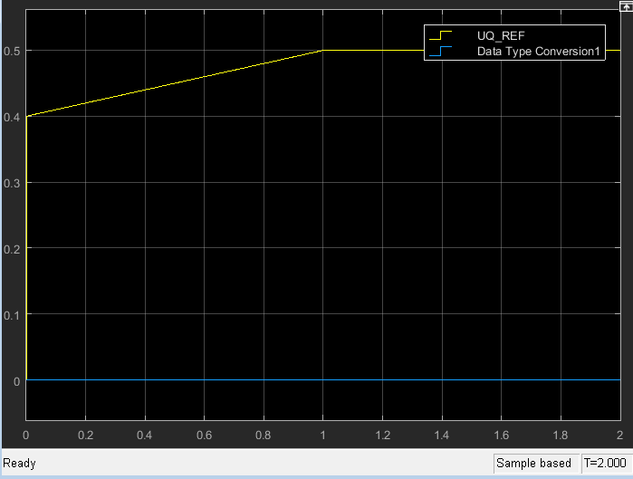

You need to find a proper V/f profile. If you apply too much or too less voltage to soon/late you will see oscillation.
E.g: if i change your model to us a LUT like this:
Then the result is:
In the beginning there are some speed oscillations that are translated into large back-emf value. So, at this point i think is important to have various checkpoint on the V/f profile to match with the motor itself.
Also, the acceleration slope might play an important role here. Perhaps you should try with a lower acceleration. Do do that you will need to update your model as it has been suggested here: https://community.nxp.com/message/984460?commentID=984460&et=watches.email.thread#comment-981795
Hope this helps!
