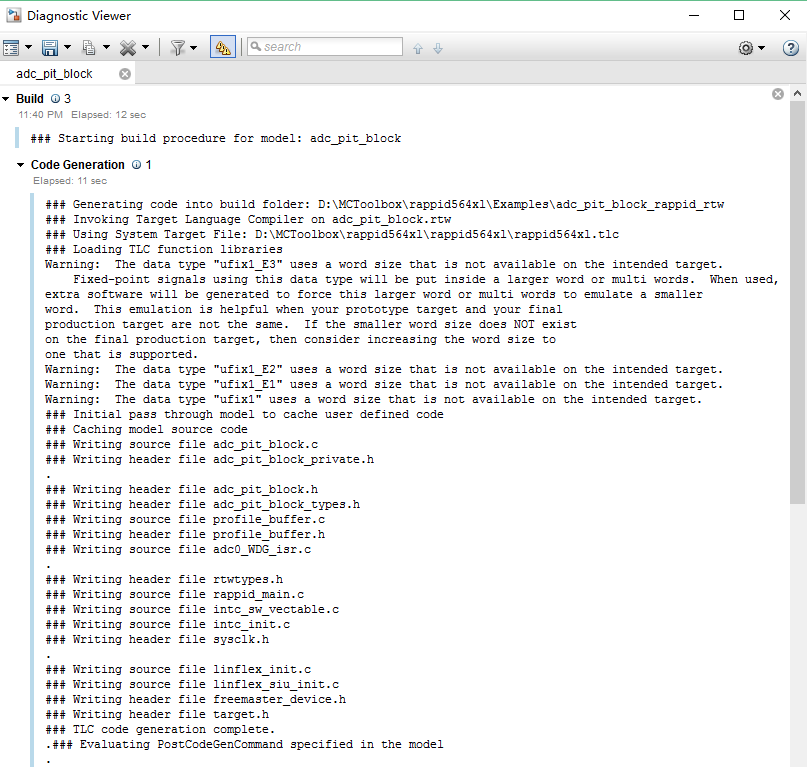

hjhjhj
    The matlab version used by me is matlab2015b and  the  Toolbox version  for MPC5643L  is 1.3. By the way,my computer system is WIN10.
      The  Diagnostic Viewer
   Thanks for your help!

Daniel_Popa
Hi hj,
I re-tested the toolbox using your setup: Win10+Matlab 2015b on 64b and fresh install of 1.3 version and it works. See the attachment. Can you compare the folder content with the one generated on your computer? Does it contains the same files?
