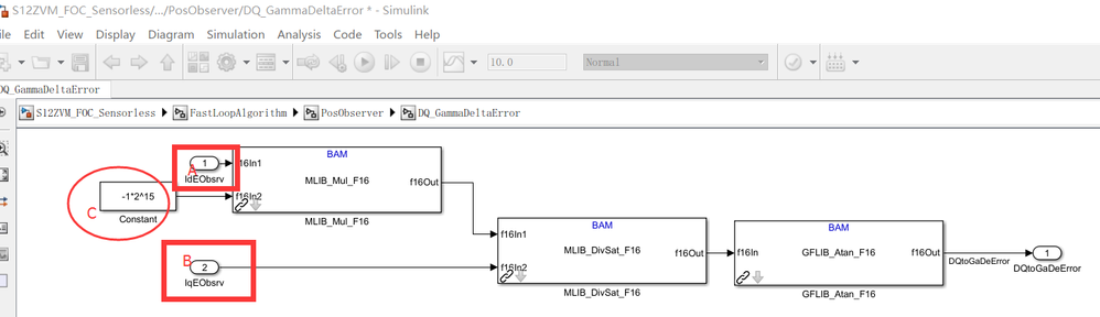

Hi Daniel,
About the model of S12ZVM_FOC_Sensorless,shown as below, i wanna make sure the IdEObsrv(Part A shown) and IqEObsrv(Part B shown) is EMF or not ?  i  thought is EMF, my reason ,EMF contains the position and speed of rotor, to get the Postion of the rotor using the arctan() Function,namely Theat=arctan(EAlpha/EBeta),
and there is another doubt that the -1*2^15 in Part C,why we multiplied the -1*2^15 with IdEObsrv?

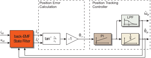

The model implemented in the example is based on this method. The main equation that describes the method is.
The "-1" scaled in Q15 is a trick to optimize the math computations within Simulink Model.
Bottom line all that model implements something like this
Hope this clarify both questions.

Hi Daniel,
Firstly,Thank you for reply! what you said  above  that " The "-1" scaled in Q15 is a trick to optimize the math computations within Simulink Model. " if so,it can not  lead the error?
Best Regards!
Eden Li
2,178 Views
Daniel_Popa
Hi Eden Li,
I should not lead to errors because basically it just change the sign of the estimated ID current sooner that leads to angle computation instead of changing the sign of the angle later on.
That's why i said is a "trick".
You can do it both ways.
Hope it helps!
2,178 Views
edenli
Contributor V
Hi Daniel,
multiplied the 2^15 is  not also lead the charging above the value  of Id,is this just a Datatype of Q15?
Best Regard!
Eden Li
2,178 Views
Daniel_Popa
Both inputs have the same data type. The result of the block is basically similar with this operation: (ID)x(-1)
