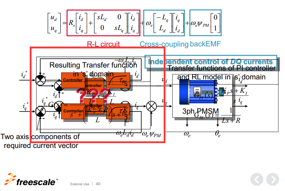

Stage 1: represent the closed loop control implementation. The QUESTION ??? is how to compute the controller parameters if you know the plant model?
Stage 2: Based on control system theory both the plant==motor electrical model==Grl(s) and the current controller==Gpi(s) are 1st order transfer functions
Stage 3: if you perform the computations shown in https://community.nxp.com/thread/450679#comment-904019
then you'll get the closed loop transfer function for each current loop.

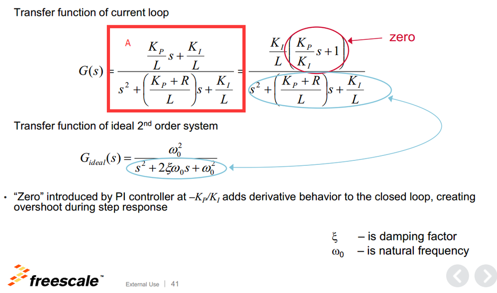

#2: I don't know how to deduce the transfer function in the Part  A (shown as below).

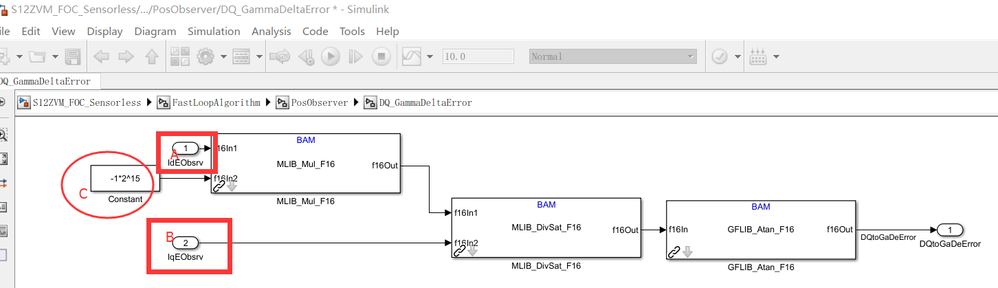

#3:About the model of S12ZVM_FOC_Sensorless,shown as below, i wanna make sure the IdEObsrv(Part A shown) and IqEObsrv(Part B shown) is EMF or not ?  i  thought is EMF, my reason ,EMF contains the position and speed of rotor, to get the Postion of the rotor using the arctan() Function,namely Theat=arctan(EAlpha/EBeta),
and there is another doubt that the -1*2^15 in Part C,why we multiplied the -1*2^15 with IdEObsrv?

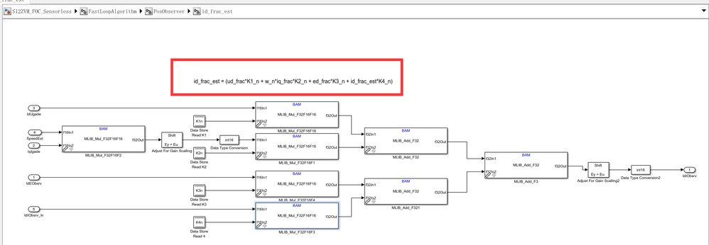

#4:Shown as below,how to deduce the id_frac_est = (ud_frac*K1_n + w_n*iq_frac*K2_n + ed_frac*K3_n + id_frac_est*K4_n)?
I don't know how to deduce it,and the id_frac_est  is deduced form  EMF?

For #2, that transfer function represents the closed loop computation for a first order RL system controlled via a PI controller (1st order)
Since it's quite a pain to write all the math in html i'm attaching a picture with computations. Please excuse my hand-writing.
