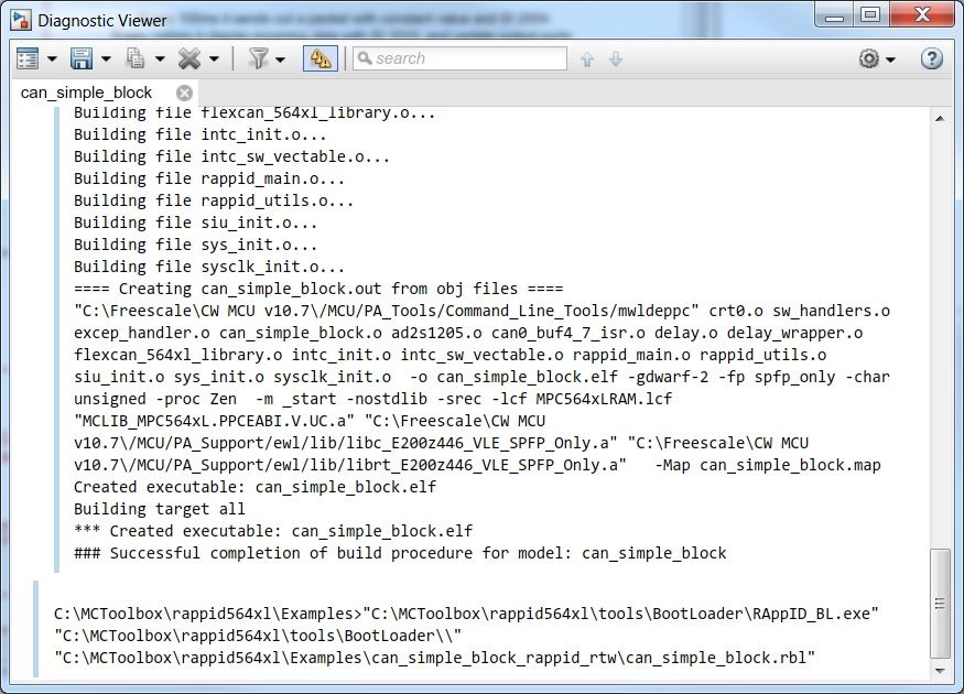

Hello everyone,
   When I built the can_simple_block_rappid_rtw_demo,it could not generate .mot file,and an error accoured ,which hinted that  the RAppID Boot Loader failed to find can_simple_block_rappid_rtw.mot .捕获.PNG

This is a bit strange. I can't reproduce the problem on my side. Can you give me a few details about your setup:
- matlab version
- toolbox version
- a copy of the Matlab Diagnostic Viewer
Looking forward to hearing from you soon.
Thank you!

    The matlab version used by me is matlab2015b and  the  Toolbox version  for MPC5643L  is 1.3. By the way,my computer system is WIN10.
      The  Diagnostic Viewer

Daniel_Popa
Hi hj,
Can you or someone else translate the error message into English?
Does it says:
'"C:/"Program' is not recognized as an internal or external command,
operable program or batch file.
gmake: *** [crt0.o] Error 1
If so, then you have not set correctly the system variable for MW_TOOL.

Daniel_Popa
It is caused by the wrong placement of the " " in the path of the system variable. Remove those " " and just copy paste the location from a Window explorer.

hjhjhj
Hi Daniel,
     I solved it with your method .
Thanks a lot.
