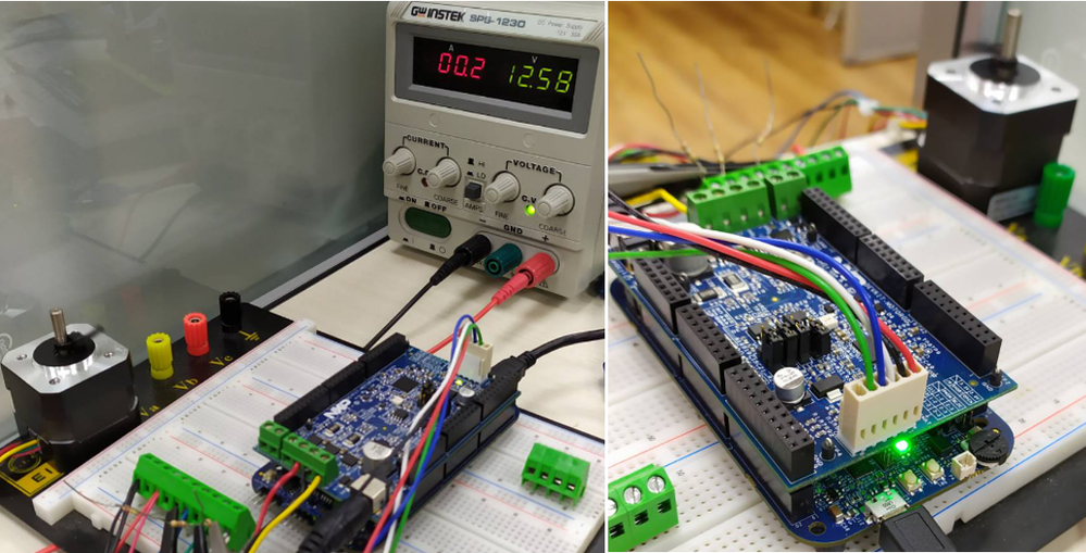

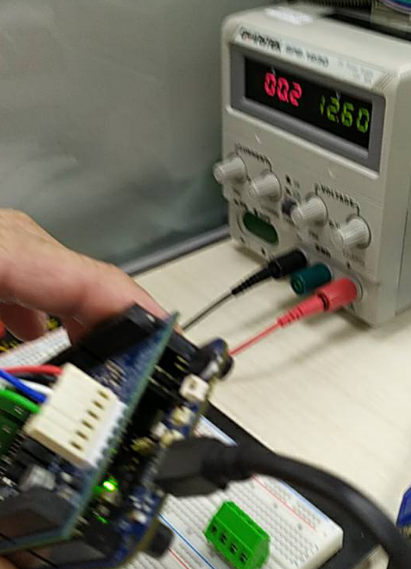

c9356j
Hi mikedoidge
1) Generate code and build model from MATLAB, then use RAppID Bootloader to flash over JTAG is WORKING.
-- >  (a).rar
         ClosedLoop_Control.mot" -- > This file is ok .
Step1. Matlab - - > Simulink , Generate code and build “Lecture12_MPC5744P_v3.0.0
Step2. RAppID BL Tools , Download Firmware “ClosedLoop_Control.mot
Step3. DEVKIT – MPC5744P “LED Red ON” Motor Power OFF
Step4. DEVKIT – MPC5744P “LED Green ON” Motor Power ON
2) Generate code and S32DS Project file from MATLAB, then use S32DS to builld and then use RAppID Bootloader to flash over JTAG is NOT WORKING.
-- >  (b).rar
       "ClosedLoop_Control_mbd_rtw.srec "--- > is not working
Step1. Matlab - - > S32DS Open *.xml File, Generate code and build
Step2. RAppID BL Tools , Download Firmware “ClosedLoop_Control_mbd_rtw.srec
Step3. DEVKIT – MPC5744P “LED Red OFF” Motor Power OFF
Step4. DEVKIT – MPC5744P “LED Green OFF” Motor Power ON
9,051 Views
