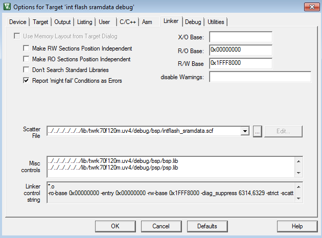

I am using keil IDE and mqx 4.1. The board I am using is twr-k70f120m. I want to integrate two projects into a single project.
1) Freescale_MQX_4_1\rtcs\examples\snmp
2) Freescale_MQX_4_1\mqx\examples\spi
3) Freescale_MQX_4_1\mfs\examples\sdcard
I want to integrate the above projects into a single project and the three project's functionality should work. How do I do it ? what files should I add and how do I add the libraries?

Yes, you also need to merge the include files for sdcard and spi into snmp project.
This same also applies to linker
as you can see, snmp only linked bsp.lib and psp.lib,   since you will add sdcard,  then mfs.lib will be included here

Hi Vibhu:
You can start with SNMP project, then add the other application code to the snmp project.
Libraies are the same.
You should also take care the user_config.h file, merge the 3 configuations into one file

Hi Daniel,
Thank you for your reply !
Just for clarification, aren't the build files in separate folders like for sdcard it will be inside the mfs->source->include and for snmp it will be inside rtcs->source->include folder?
If I include #include <mfs.h> in snmp file it is giving header file not found.
Should I change anything in keil ?
Please Help.
