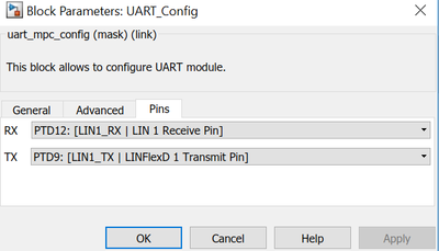

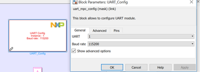

1. I am using sample model that NXP has given as sample that sends "Hello World". I have observed it works with UART0.
2. I have changed UART0 -> UART1 and have selected PTD12 and PTD9 for RX and TX pins.
3. Then I embedded the code.

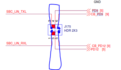

4. I connected J175 so that; 1 and 5; 2 and 6 are shorted.

if there are jumpers on J175 then remove default connection (2-4,1-3) and place it to 4-6, 3-5 position.

what is the board revision you have. For example on rev.E J3-02 and J3-04 are not connected to PD12 and PD9 by default, can be done via jumpers on J175 header. Refer to board's schematic.

We are using rev E board. As far as your statement, I understand that what I am doing is right. When I switch J175 Jumper it will work. Am I right?
