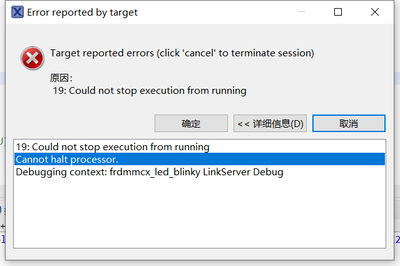

It is failed to set break point when debugging with following MCG configuration.
It run well without debugging.

Error report
My board is FRDM-MCXC242.
How to deal with the problem?

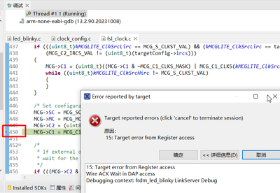

I set the clock configuration based on demo app led_blinky.
Then update the source files.
And step-by-step dubugging caused error like below.

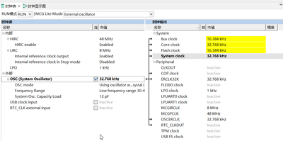

The part of the automatically generated clock_config.c is as follows:
void BOARD_InitBootClocks(void)
    BOARD_BootClockRUN();
 ********************** Configuration BOARD_BootClockRUN ***********************
/* clang-format off */
/* TEXT BELOW IS USED AS SETTING FOR TOOLS *************************************
!!Configuration
called_from_default_init: true
outputs:
- {id: Bus_clock.outFreq, value: 16.384 kHz}
- {id: Core_clock.outFreq, value: 32.768 kHz}
- {id: ERCLK32K.outFreq, value: 32.768 kHz}
- {id: Flash_clock.outFreq, value: 16.384 kHz}
- {id: LPO_clock.outFreq, value: 1 kHz}
- {id: MCGIRCLK.outFreq, value: 8 MHz}
- {id: MCGPCLK.outFreq, value: 48 MHz}
- {id: OSCERCLK.outFreq, value: 32.768 kHz}
- {id: System_clock.outFreq, value: 32.768 kHz}
settings:
- {id: MCGMode, value: EXT}
- {id: MCG.CLKS.sel, value: SIM.OSCCLK}
- {id: MCG_C2_OSC_MODE_CFG, value: ModeOscLowPower}
- {id: MCG_MC_HIRCEN_CFG, value: Enabled}
- {id: OSC0_CR_ERCLKEN_CFG, value: Enabled}
- {id: OSC_CR_ERCLKEN_CFG, value: Enabled}
- {id: OSC_CR_SYS_OSC_CAP_LOAD_CFG, value: SC12PF}
- {id: SIM.CLKOUTSEL.sel, value: MCG.MCGPCLK}
- {id: SIM.COPCLKSEL.sel, value: OSC.OSCERCLK}
- {id: SIM.FLEXIOSRCSEL.sel, value: MCG.MCGPCLK}
- {id: SIM.LPUART0SRCSEL.sel, value: MCG.MCGPCLK}
- {id: SIM.LPUART1SRCSEL.sel, value: MCG.MCGPCLK}
- {id: SIM.RTCCLKOUTSEL.sel, value: OSC.OSCERCLK}
- {id: SIM.TPMSRCSEL.sel, value: MCG.MCGPCLK}
- {id: SIM.USBSRCSEL.sel, value: MCG.MCGPCLK}
sources:
- {id: MCG.HIRC.outFreq, value: 48 MHz}
- {id: OSC.OSC.outFreq, value: 32.768 kHz, enabled: true}
 * BE CAREFUL MODIFYING THIS COMMENT - IT IS YAML SETTINGS FOR TOOLS **********/
/* clang-format on */

limit1995
Dear @Alice_Yang ,
It is ok to step-over BOARD_InitBootClocks() with HIRC mode.
But it is failed to step-over BOARD_InitBootClocks() or to set break point with EXT mode. Debugging is not possible at all.
Why?
And I want to know how to debug with EXT mode.
