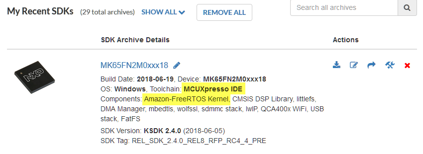

Hello Everyone,
I am trying to create a new project using the SDK for the Kinetis K65 MCU, which I was able to create via MCUXpresso SDK builder and import it in the IDE successfully. When I arrive at the 'Configure the project' screen, under 'OS', I am only able to select "baremetal". I don't see any option to select FreeRTOS as shown in the following video tutorial:  Video Link : 7772  @ the 2:05 mins mark.

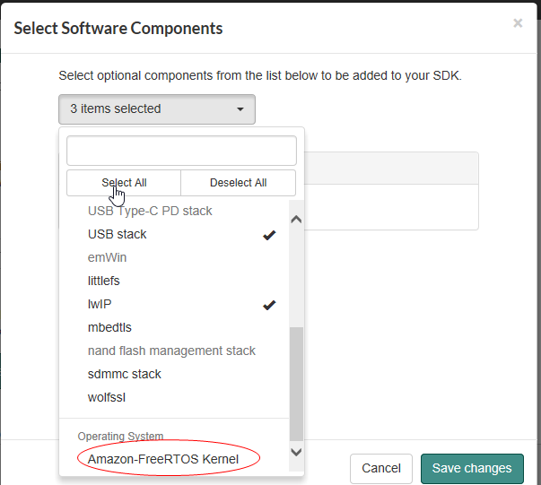

Hello Joseph Jean-Jacques,
When you downloas SDK package, please be sure select FreeRTOS system:
then delete the orignal SDK from your IDE, plug the new one. Thus, you can create new project with FreeRTOS.
Hope it helps,
Hope it helps,

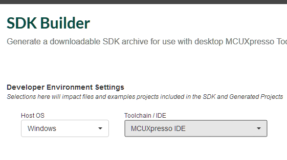

Hi Joseph,
I think this is the same problem: In the SDK builder for your SDK, make sure you select your toolchain. I think you selected IAR. Make sure you select MCUXrpresso IDE:
I hope this helps,

Hi Erich,
Thanks for the response. I did go back to the MCUXpresso SDK builder site and accessed my dashboard. Based on the information presented on my SDK, I did create it with MCUXpresso IDE selected as the tool chain. I think the issue I am dealing is more similar to what was discussed in the following threads: Migraton from IAR project to LPCXpresso IDE

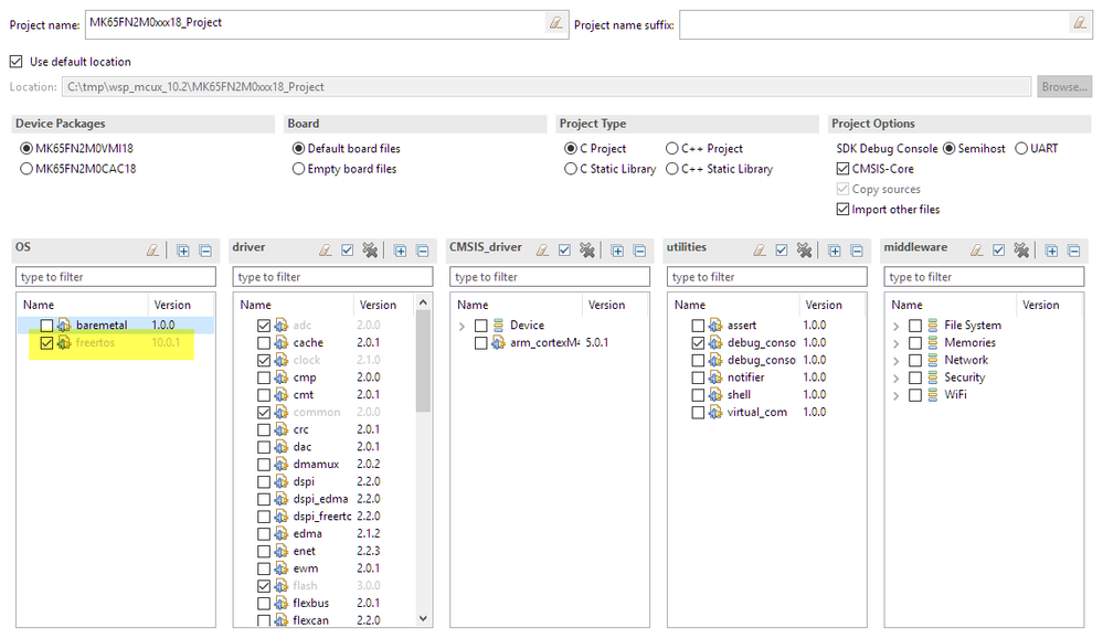

Hi Joseph,
I don't think that this is an IAR porting thing: if you select the MCUXpresso IDE with FreeRTOS, then the SDK and examples already are setup correctly (no porting needed).
Make sure you have it present in your configuration:
Then you will have FreeRTOS listed:
I hope this helps,
Erich
