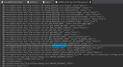

In the debug perspective I can't use the restart button, due to fact it's not enabled.
But in the customized perspective it's still enabled. There is something different to set ?

I had the same problem on a couple new projects.  I think the problem happens when the debug configuration is created.  I tried a few things and found if I remove this line from the .launch file the restart button becomes active:
<stringAttribute key="org.eclipse.cdt.launch.DEBUGGER_START_MODE" value="remote"/>
Give that a try, maybe it will help you as well.

It is present in the .launch configuration file you are using. Open the .launch inside your project with a text editor or inside Eclipse
36,661件の閲覧回数
Toe
By default it is in the workspace directory:
workspace\.metadata\.plugins\org.eclipse.debug.core\.launches
But you can also make it a file that is local to the project by going to the debug configuration, Common tab, and select "Shared File"

Toe
I found the problem by doing a diff between different .launch files. I had a few that did have the restart button active and some that didn't. I tried a few options before narrowing in that the DEBUGGER_START_MODE tag was the culprit in the non-working launch and removing it

9.) I usually create my launch configurations by going to the debug configurations screen and double clicking on the interface I intend to use. This generates a basic configuration that I can edit. By default these are set to be saved as a "local" file which lives in the workspace dir for the IDE; this can be changed to a "shared" file and is easier to find. This method of generation obviously does things different than the blue button method.
10.) No, the file generated that way does not have the broken line.
11.) The file is attached.
It seems that the debug configuration manager needs to use the same method of generating the .launch file as the blue button from the quickstart panel. That configuration manager is the way files are accessed or modified after they are created anyway.

Thanks a lot. This is valuable information. So long story short, only manually created PEmicro debug configurations cause the described behavior. Now that we narrowed down the problem, we'll try to reproduce it on our side.

I didn't try till today yours suggestions. Now, finally, the restart button works properly. It's not enought to delete the .launch files and recreate it. The the string attribute key DEBUGGER_START_MODE, must be removed too from file otherwise the button is always locked.

That's an interesting route.
But I do have this
present in my launch files and the restart button is enable too.
Curious how removing it would trigger something different?
But worth a try for sure, let us know.
