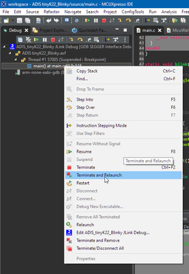

38,199 Views
ErichStyger
Specialist I
Hi @claudiobrunelli ,
can you check if Terminate & Relaunch
Works for you?
Erich
38,174 Views
claudiobrunelli
Hi guys, thanks for your help.
Yes Erich I tried with terminate & launch. But the button is still disabled.

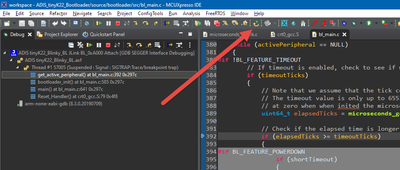

ErichStyger
Specialist I
could you share a screenshot and the version/host you are on by now?
I'm on Win10 64 J-Link and on 11.2.1 and I can tell it works for me:
Few ideas what could cause this:
- did you try with a fresh/new workspace too?
- reset the perspective(s)?
- did you had the 'Quickstart' view open/active: this one seems to have an impact on the debug icons, so make sure it is shown at least once.

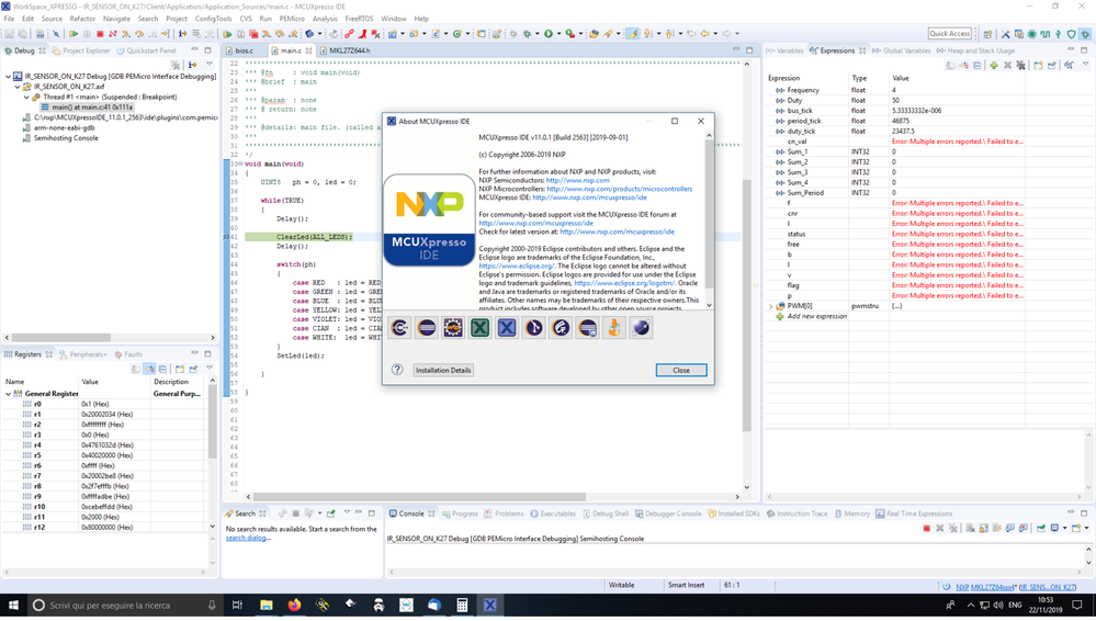

claudiobrunelli
Hi Erich
I'm using a window 10 PRO, just a freedom board based on KE16 (but I did the same problem on K27 and a factory target too) and the system debug was at the beginning the open SDA than now a Universal multilink of PEMicro.
But it's still doesn't work this button. My collegues too, have the same problem. If you need other info I can give it of course.
Thanks in advance, Claudio

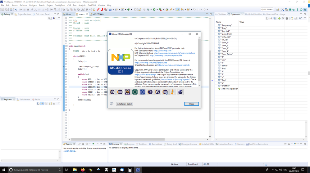

claudiobrunelli
I take note about your answer. Just to clarify than, I send you other screenshot where there's my xpresso release.
If you have news about this strange problem, please advice me. Thanks a lot.

lpcxpresso_supp
It should be enabled. Please note that its enablement depends on the currently selected context from Debug view. In other words, you'll have to select the thread or the main process, not the top-level item associated with the debug configuration.

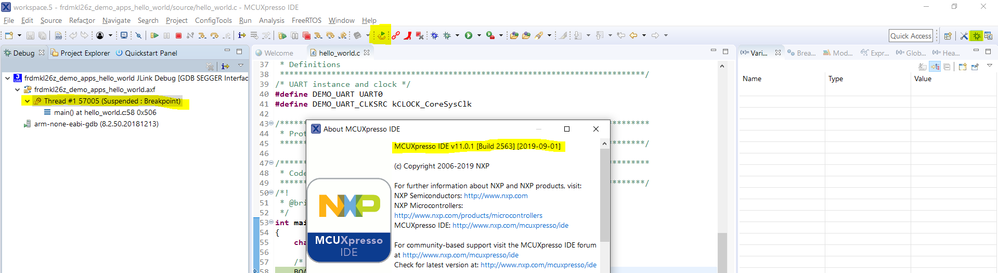

ErichStyger
Specialist I
The screenshot actually shows that a context (and not the top level item) is selected, and the restart button is disabled. So imho this is caused by this.
I thought it might be related to the P&E debug probe, but I have it working on my side (just checked again) (see my screenshot). So all good there (using K22)
I don't have a KE device so not sure if this is related to the device or not.
