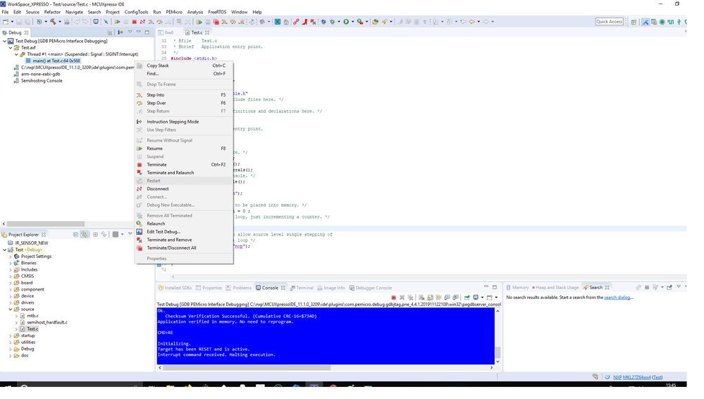

lpcxpresso_supp
We cannnot reproduce any problems with the Restart button.
Please can you try selecting different levels within the Debug View, and see if this causes it to be reenabled. Please also confirm what host OS you are running, and what debug probe you are connected through, and to what target MCU.
Also, if you use the right click menu in the Debug View, do you see the Restart option in that menu being active?
MCUXpresso IDE Support
20,681 Views
claudiobrunelli
I tried more times to change debug level, but this is the result shown in the attached file.
My OS is Window 10 pro 10.0.17134, build 17134.
I'm using the Freedom Board KL27 based on MKL27Z64 and the debug port is the OpenSDA port.
Nothing more.
This problem happen both with my own project and a projects totally generated by the wizard.
Thank you for your assistance.
Claudio

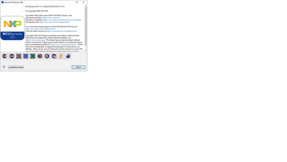

claudiobrunelli
Hi.
Did you do something for restart button ?
I have just installed the latest version of mcux presso  v11.1.0 [build3209] [2019-12-12] but this button doesn't work yet.
I tried this release on a different pc too, this time portable, but nothing.
Any news about it ?
Thanks.
Claudio

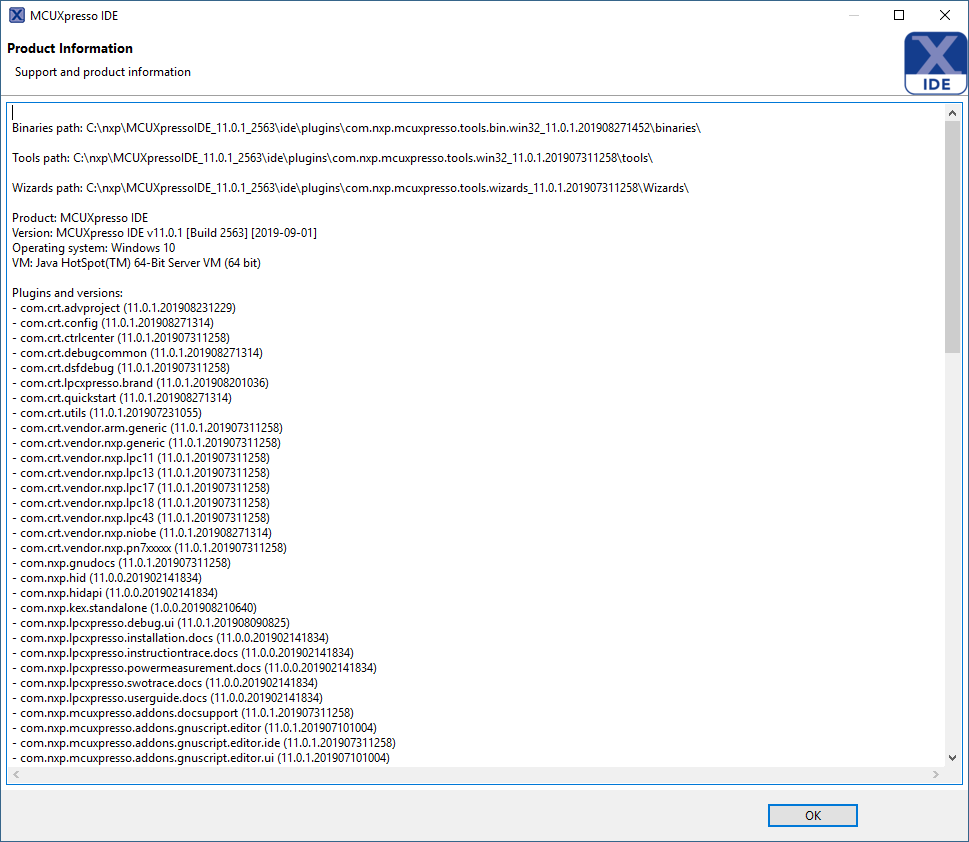

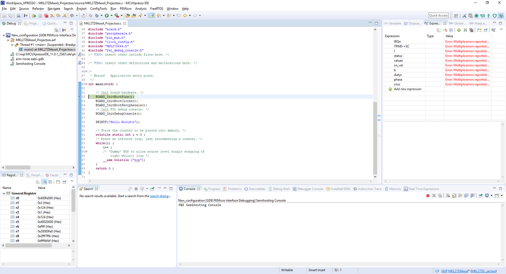

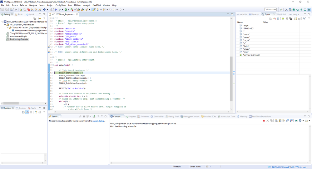

claudiobrunelli
Good morning and thanks.
1) IDE version is 11.0.1
2) Board is FRDMK27
3) Yes
4) No it's not enabled.
As_soon_as_load_debug.pngAt_StartUp.pngC_Perspective.pngDebugPerpspective.pngDevelopPerspective.pngInfo.png
