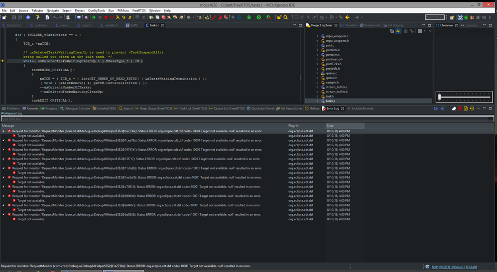

scottm
Senior Contributor II
Nope, nothing in that console.  I tried resetting the perspective and restarting, and rebooted for good measure, but nothing.  I do get plenty of errors but I don't know if they're related:
