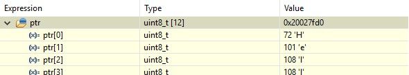

victorjimenez
Hello Mrunal Ahirrao,
How are you calling the function Chip_SSP_WriteFrames_Blocking in your program? The variable buffer is already a pointer, so you don't have to use the & operand. For example, I have the following lines of code:
uint8_t ptr[] = "Hello World";
uint8_t *ptr2;
ptr2 = ptr;‍‍‍‍‍‍‍‍‍
Where the address of ptr is the following
And once you run the line ptr2 = ptr; the value of ptr2 is the following
I think what is happening in your case is that when you called the function Chip_SSP_WriteFrames_Blocking  you passed as argument  the value of the buffer instead of the address and in that case you need the & operand, but this is not the correct way to pass the argument buffer.
