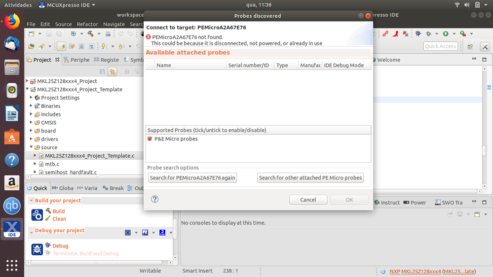

Hi, I have a problem with MCUxpressoIDE, i installed  ide on SO linux Ubuntu 18, when I was connecting the freedom FRDM-KL25Z the MCUXpresso didn't recognizes board. What can I do?

I add FRDM-KL25Z SDK on MCUxpresso, and when I connect USB cable on my PC the board pop up in the computer devices, but I click to debug and the attached image error appears, I click to "Search for PEMicroA2A67E76" and nothing happens.Captura de tela de 2018-08-15 11-38-19.png

lpcxpresso_supp
Please delete any .launch files from inside your project, then try starting a new debug session from the Quickstart Panel's Debug button.
It would probably be a good idea to update the debug probe firmware on your FRDM board too (KL25 boards often have very old firmware installed in them). Information on how to do this can be found at https://www.nxp.com/opensda.

lpcxpresso_supp
You’re going to have to be more explicit what you mean by the IDE not recognizing your board.
Which MCUXpressoIDE is installed? Did you download and import the FRDM-KL25Z SDK, etc.?
