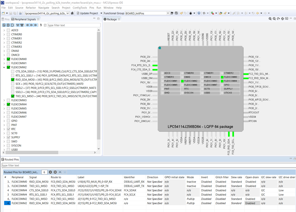

I'm using MCUXpresso IDE v10.3.1 [Build 2233] with the LPCXpresso board for LPC54114. I'm able to build and run the I2C sample "lpcxpresso54114_i2c_polling_b2b_transfer_master" and successfully communicate with an I2C slave. This sample uses FC4 as the I2C channel.
However, when I try to enable a second I2C channel (i.e. to have 2 active I2C channels), using FC2, the IDE will not allow me to configure FC2 as an I2C channel. Specifically, in the "Routed Pins" menu each I2C column ("I2C slew rate", "I2C drive strength", "I2C glitch filter") display "Selected pin does not support configuration of this feature." I tried each pin connected to FC2 but all of them display this error message. How do I enable FC2 as an I2C channel?
3,768 Views
henry_tang
Found out an important I2C configuration menu "Flexcomm Interface I2C" was missing from my IDE/SDK installation. So I uninstalled everything, did a clean install, and then was able to bring up that missing menu. With it, I was able to configure a 3rd FC channel and verify all 3 channels could communicate with unique I2C slaves.

henry_tang
Hi Alice,
According to table 205, only 4 PIO pins on 5411x MCUs provide I2C support: PIO0_23, PIO0_24, PIO0_25 and PIO0_26. Therefore a maximum of 2 unique I2C buses are simultaneously supported. Please confirm this and I will close this issue.
Does NXP provide any MCU that supports 4 or more unique I2C buses simultaneously?

henry_tang
Hi Alice,
Your screenshot shows the same problem that I am describing, that FC2 is not configured for I2C operation (see the RED box in my image below). Compare those settings with FC4 (the GREEN box in my image) which is properly configured for I2C.
I experimented and found that FC2, FC3, FC5, FC6 and FC7 all show the configuration problem described above. Only FC1 and FC4 can be configured for I2C operation.
Also note that the auto-generated pin_mux.c code for FC2 is completely different from FC4:

3,768 Views
Hello Henry,
Each port pin PIOm_n has one IOCON register assigned to control the characteristics of
the pin. Not the same. About the detail please refer to Table 205 of LPC54114 User Manual.
For example the P0_8 of used for FLEXOMM2 on your screenshot, it use " 9.5.1 Type D IOCON registers (PIO0)",
while P0_25 for FlEXCOMM4 use the register of "9.5.2 Type I IOCON registers (PIO0)".
Hope it helps,
TIC
