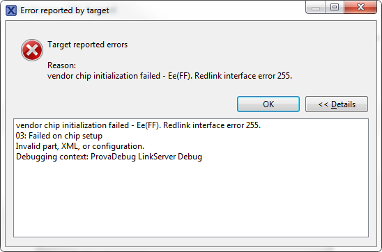

Buongiorno.
Sto provando a scaricare il programma "Hello World" fornito con l'SDK nella scheda MIMXRT1050-EVK.
All'atto del download, però, ottengo sempre questo errore:
Ecco l'uscita della Console:

failed to find a target memory area to use to test the Debug Access Port
required information about vendor NXP chip MIMXRT1052xxxxx not found
Failed on chip setup: Ec(01). Invalid part, XML, or configuration.
error closing down debug session - Ee(FF). Redlink interface error 255.
La versione di MCUXpresso-IDE è questa:
MCUXpresso IDE v10.1.0 [Build 589] [2017-11-14]
Potreste darmi un aiuto?
Grazie.

We have a theory as to what the cause of your problems may be.
Please can you follow the process to mass erase the Hyperflash that is detailed in the Troubleshooting section of Overview of using the MIMXRT1050-EVK with MCUXpresso IDE
After doing this, power the board down and then back up again. And then try debugging your project again. Does this then work?

massimopalmieri
Following the instructions on the above document, i have created a new projects and inserted the preprocessor directive "XIP_EXTERNAL_FLASH". Then i compiled and launched debugger and these are the results:
Console window:

chip initialization failed - Ee(FF). Redlink interface error 255.
Then i have imported the led SDK example and added the SDRAM script. I launched the debugger and this is the result:

Now I have done the procedure to mass erase the hyper flash:
and now the debugger IS FUNTIONING.
I re-tried debugging in flash and in SDRAM and both are ok!
But it's right that to pass from an instruction and another the debugger takes several seconds? (almost 6 seconds)??

massimopalmieri
Thank you for your reply. The jumper config seems to be correct: the green led is lit.
Now I try to power the board via a 5V power supply and set J1 in 1-2 position. The led is light green but when I try to download the program i take this answer:
MCUXpresso RedlinkMulti Driver v10.1 (Nov  9 2017 16:45:39 - crt_emu_cm_redlink build 360)
Found chip XML file in E:/nxp/Workspace/evkmimxrt1050_demo_apps_hello_world/Debug\MIMXRT1052xxxxx.xml
Reconnected to existing redlink server (PID 4294967295)
Connecting to probe 1 core 0 (server PID unknown) gave 'OK'
Probe Firmware: DAPLink CMSIS-DAP (ARM)
Serial Number:  0227000041114e450030300dc40300535ab1000097969900
VID:PID:  0D28:0204
USB Path: \\?\hid#vid_0d28&pid_0204&mi_03#9&29aa56e6&0&0000#{4d1e55b2-f16f-11cf-88cb-001111000030}
debug interface type      = <unknown> (DAP DP ID 0BD11477) over SWD
processor type            = Cortex-M7 (CPU ID 410FC270)
number of h/w breakpoints = 8
number of flash patches   = 0
number of h/w watchpoints = 4
Probe(0): Connected&Reset. DpID: 0BD11477. CpuID: 410FC270. Info: <None>
Debug protocol: SWD. RTCK: Disabled. Vector catch: Disabled.
Content of CoreSight Debug ROM(s):
RBASE E00FD000: CID B105100D PID 000008E88C ROM dev (type 0x1)
ROM 1 E00FE000: CID B105100D PID 04000BB4C8 ROM dev (type 0x1)
ROM 2 E00FF000: CID B105100D PID 04000BB4C7 ROM dev (type 0x1)
ROM 3 E000E000: CID B105E00D PID 04000BB00C ChipIP dev SCS (type 0x0)
ROM 3 E0001000: CID B105E00D PID 04000BB002 ChipIP dev DWT (type 0x0)
ROM 3 E0002000: CID B105E00D PID 04000BB00E ChipIP dev (type 0x0)
ROM 3 E0000000: CID B105E00D PID 04000BB001 ChipIP dev ITM (type 0x0)
ROM 2 E0041000: CID B105900D PID 04001BB975 ARCH 23B:4A13r0 CoreSight dev type 0x13 Trace Source - core
ROM 2 E0042000: CID B105900D PID 04004BB906 CoreSight dev type 0x14 Debug Control - Trigger, e.g. ECT
ROM 1 E0040000: CID B105900D PID 04000BB9A9 CoreSight dev type 0x11 Trace Sink - TPIU
ROM 1 E0043000: CID B105F00D PID 04001BB101 System dev (type 0x0)
CM7 Rev. 0.0  DTCM: 512KB  ITCM: 512KB
LoUU: Level 2: LoC: Level 2
Level 1 Cache Type: Instruction+Data
ICache 32K: WT: Y WB: Y RA: Y WA: Y NumSets:  512 Assoc:   2 LineSize:  8
DCache 32K: WT: Y WB: Y RA: Y WA: Y NumSets:  256 Assoc:   4 LineSize:  8
That is the same as before.
I don't know if there is some configuration i miss in my IDE or in my board.
I need some help: I am new in working with this IDE.
5,817 Views
