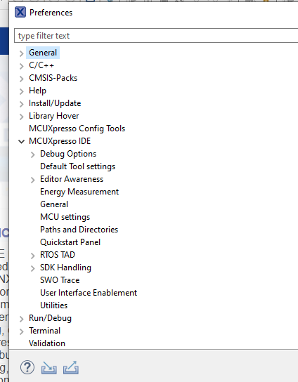

Hello, my work computer is not connected to the internet so I have to download the SDK from another computer and manually install it. I have some instructions:
https://community.nxp.com/t5/MCUXpresso-IDE-Knowledge-Base/Importing-an-MCUXpresso-SDK-into-MCUXpres...
These instructions are from 2017 and the Windows>Preferences Window looks a little different. There is no SDK Options listed under the MCUXpresso IDE.
Here is my view:
Can anyone help me with installing an SDK manually please?

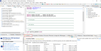

Hi @joe1652
To install SDK package to MCUXpresso IDE, pls follow steps:
1. Select the board and download the package from  https://mcuxpresso.nxp.com/en/select
2. Make sure select toolchain as "All" or "MCUXpresso IDE", online build the package and download the zip file
3. Open MCUXpresso IDE. Drag the SDK zip file to IDE "Installed SDKs" window
Hope this helps,
Jun Zhang
