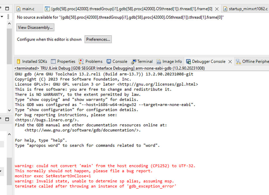

However, if I convert the probe to a J-Link, by running “program_JLINK.cmd script” from MCU-LINK_installer 3.153, to make it emulate a J-Link device, it consistently fails to write to flash and therefore debug. I deleted all the debug launch files to allow MCUXpresso to create the j-link configuration automatically, as suggested by IDE guide.
I then tried using the latest driver from Segger “V8.12e” instead of the one bundled with the IDE. On the first debug attempt the Segger driver updated the MCU-LINK_PRO to Seggers’s latest firmware for the connected emulator. However, it still does not work. Repeated builds and debugging do not bring up the flashing window and the output from Debugger Console is as below.

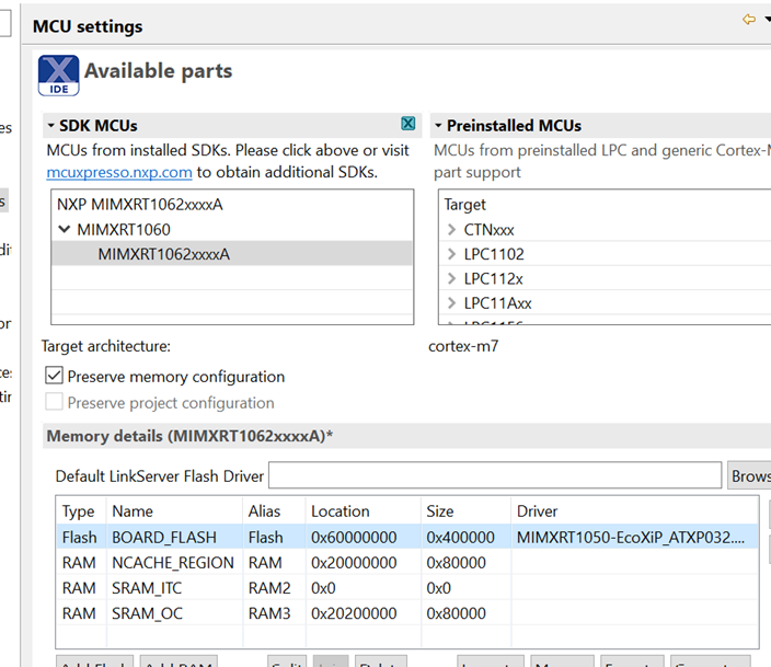

I have reconfigured the flexRAM, as below, but the code runs directly from flash, so I can't see this being an issue.

Does this issue also happen on your side with the SDK's example codes? I tried it on my side with the EVKB and I saw no issues on MCUXpresso 24.12.148. I would say it is likely an issue with your code as well, which is why you can recover the debug session once using MCU Boot Utility or Secure Provisioning Tool, and after flashing your code again, the issue appears once again.
